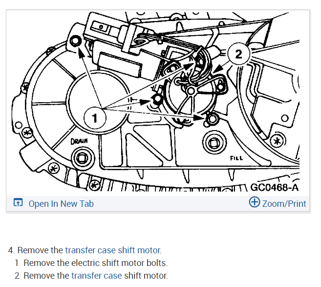

ford explorer, 1998, 77671 miles . When I started the car and went for a drive the (4wd-high and 4wd-low) lights on the dash were blinking on and off. They would blink about 5 time then turn off then repeat blinking again after a few mins. When i switch from 4wd-auto to high and also to low there was no change both times the dash lights did not light to show which mode i was in. Could there be a problem with the 4wd? Have you heard of this problem? thank you .

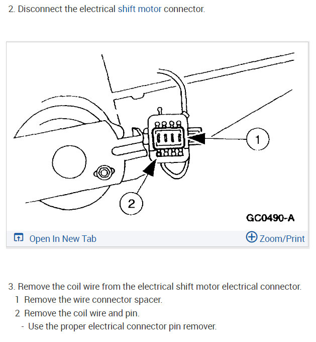

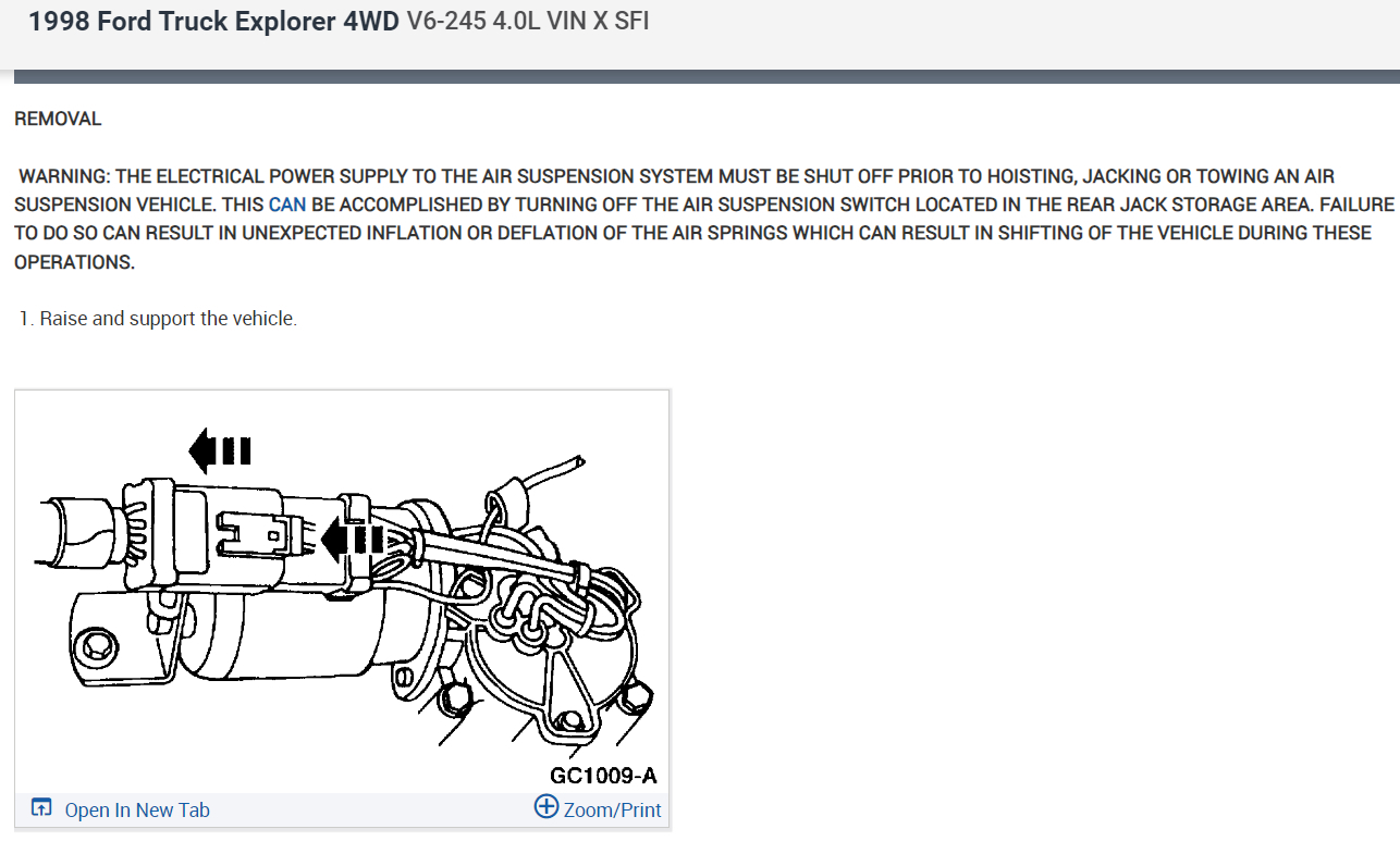

This happens when the transfer case shift actuator goes out, here is the location so you can swap it out and fix the problem. Check out the images (below). Let us know if you need anything else.
Mar 26, 2006 at 12:13 PM
Suggested Repair
Replace the transfer case shift actuator.
