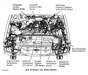

1997 Ford Explorer P0401 EGR Flow
259,000 MILES • V8 • 2WD • AUTOMATIC
K_MINER119
VIN 1FMDU32P2VUA38455

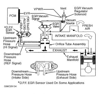

Can not find DPFE that sends code to computer. All suggestions point to replace will fix problem. Does it have one or am chasing wrong thing.
May 24, 2010 at 11:36 PM
DOCFIXIT
  • 18,828 POSTS
Several things can set code DPFE is located on left rear engine next to EGR.
