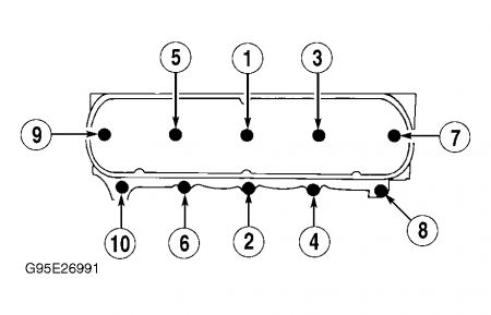

Need to know what the torque is for my vehicle. I think it is 274lb-ft@3200, but not sure. Also need to know what the tightening sequence is.

torque of 274 at 3,200 is referring to an engines torque output, not a tightening spec. you need the tightening torque specifications for the cylinder head, yes? the torque specs for the head on your vehicle is below STEP 1 tighten to 25 - 35 Ft. Lbs. STEP 2 45 - 55 Ft. Lbs. STEP 3 Additional 85 - 95 Degrees
https://images.2carpros.com/forum/automotive_pictures/261618_Graphic_468.jpg
