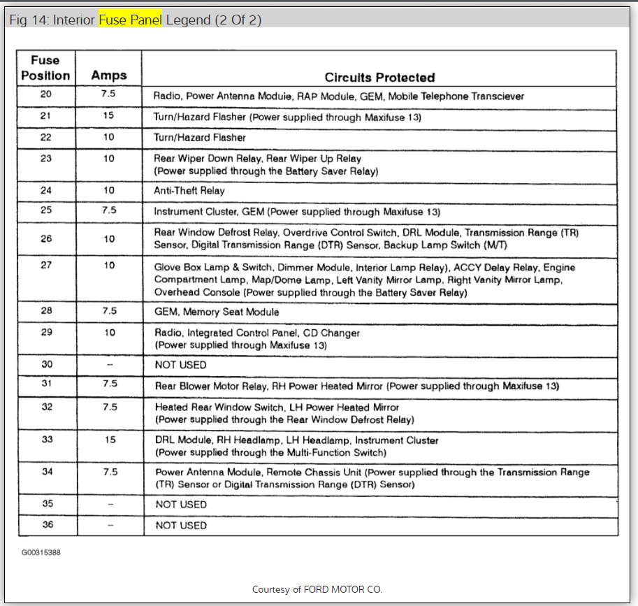

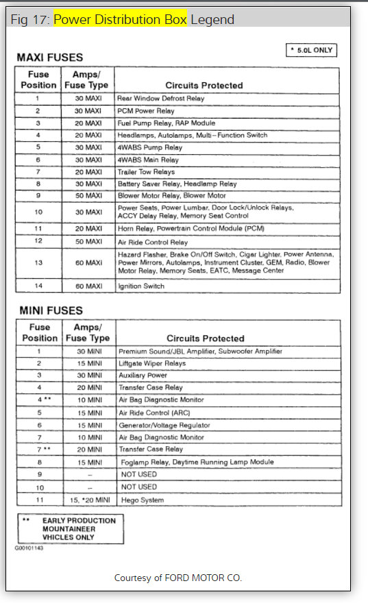

Hey MOESHA70,

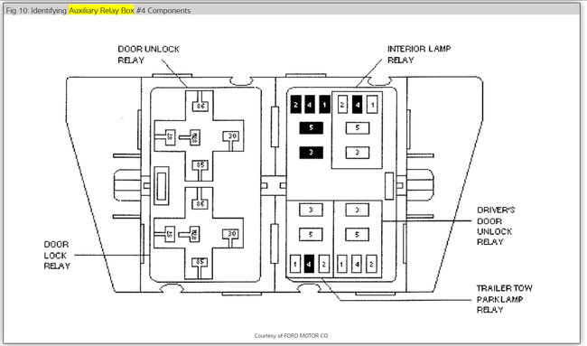

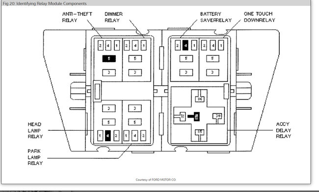

Here are diagrams (BELOW) for both the inside and under hood fuse box panels and relay locations. Here is a guide to help you test the fuses. Check the fuse locations in the diagrams below.

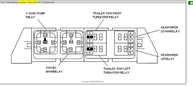

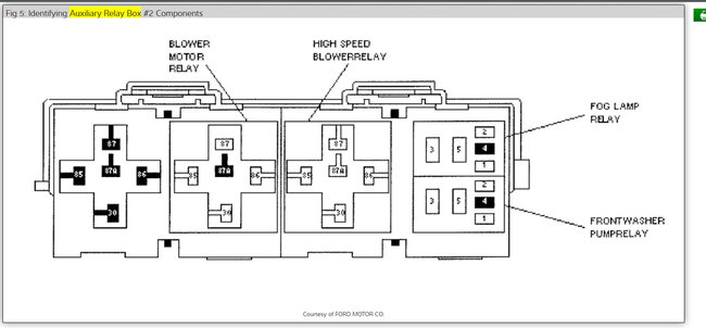

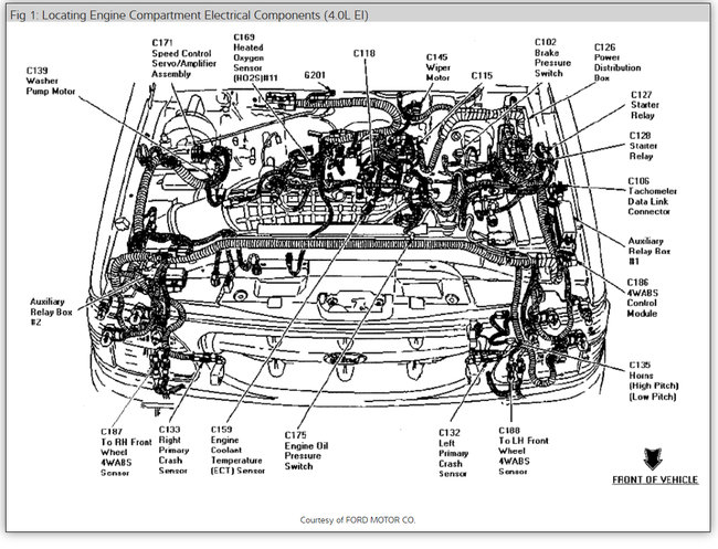

Here is a guide to help you test the fuse when you find it.
Large diagrams BELOW
https://www.2carpros.com/forum/automotive_pictures/266999_GraphicCA3IXJEQ_1.jpg
Below are the full size fuse and relay diagrams for the whole car, you should save this in your favorites for future reference as well.

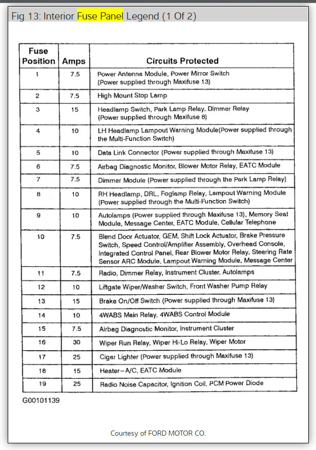

I need a schematic of the fuse panel so I can locate the proper fuse for my brake lights
Monday, January 13th, 2020 AT 8:32 PM (Merged)
DAVE H
  • 13,384 POSTS

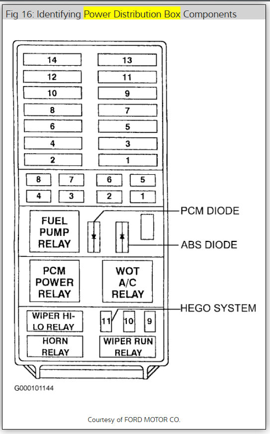

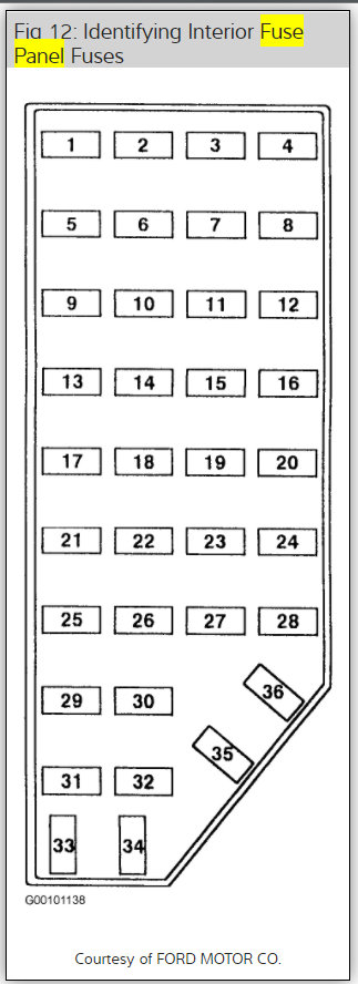

The high mount stoplamp has fuse #2 in interior fusebox rear stoplamps use fuse # 13 in underhood fuse/relay box..
