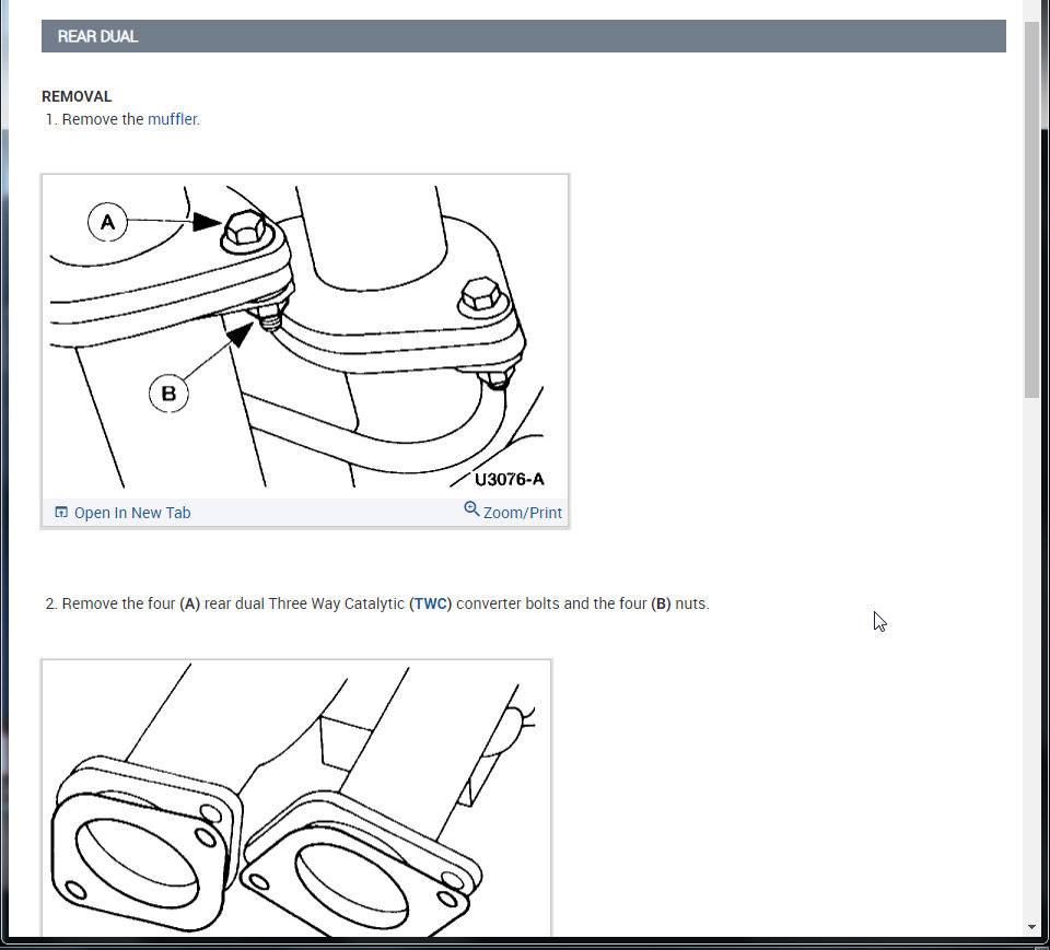

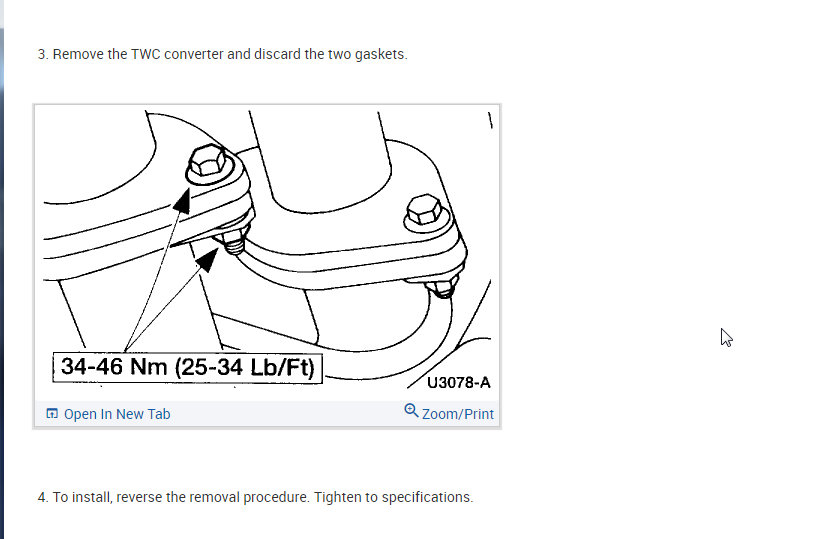

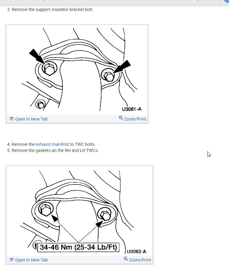

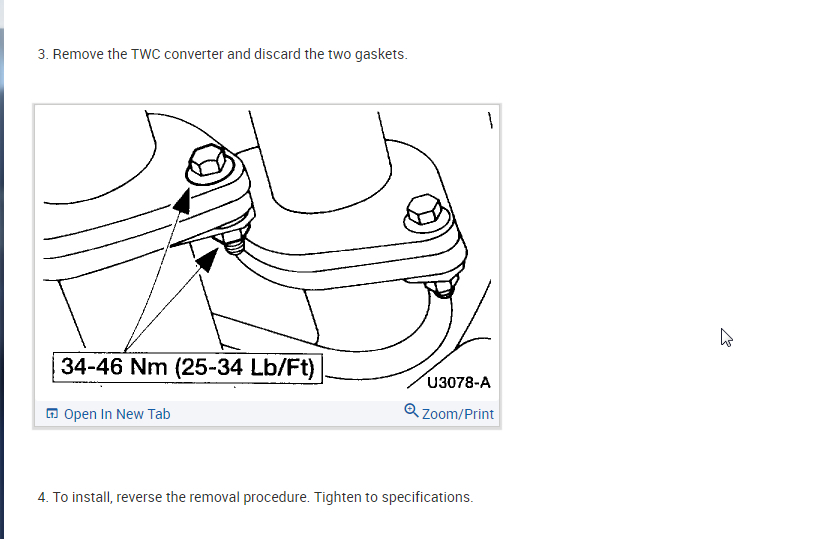

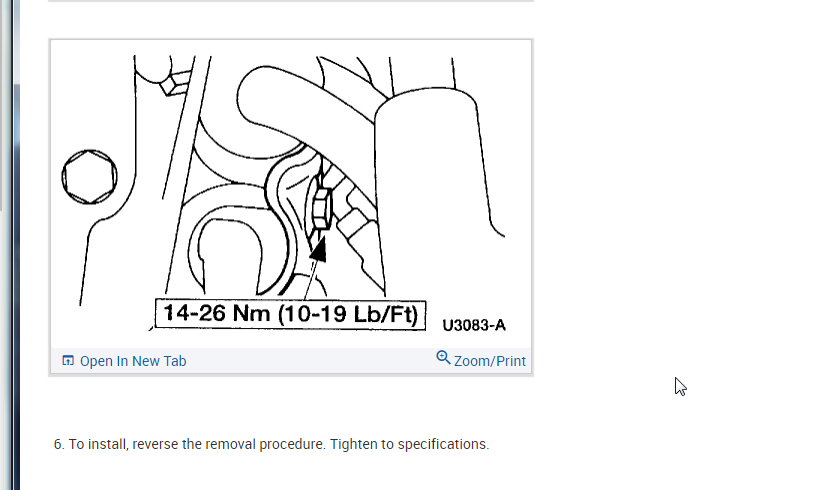

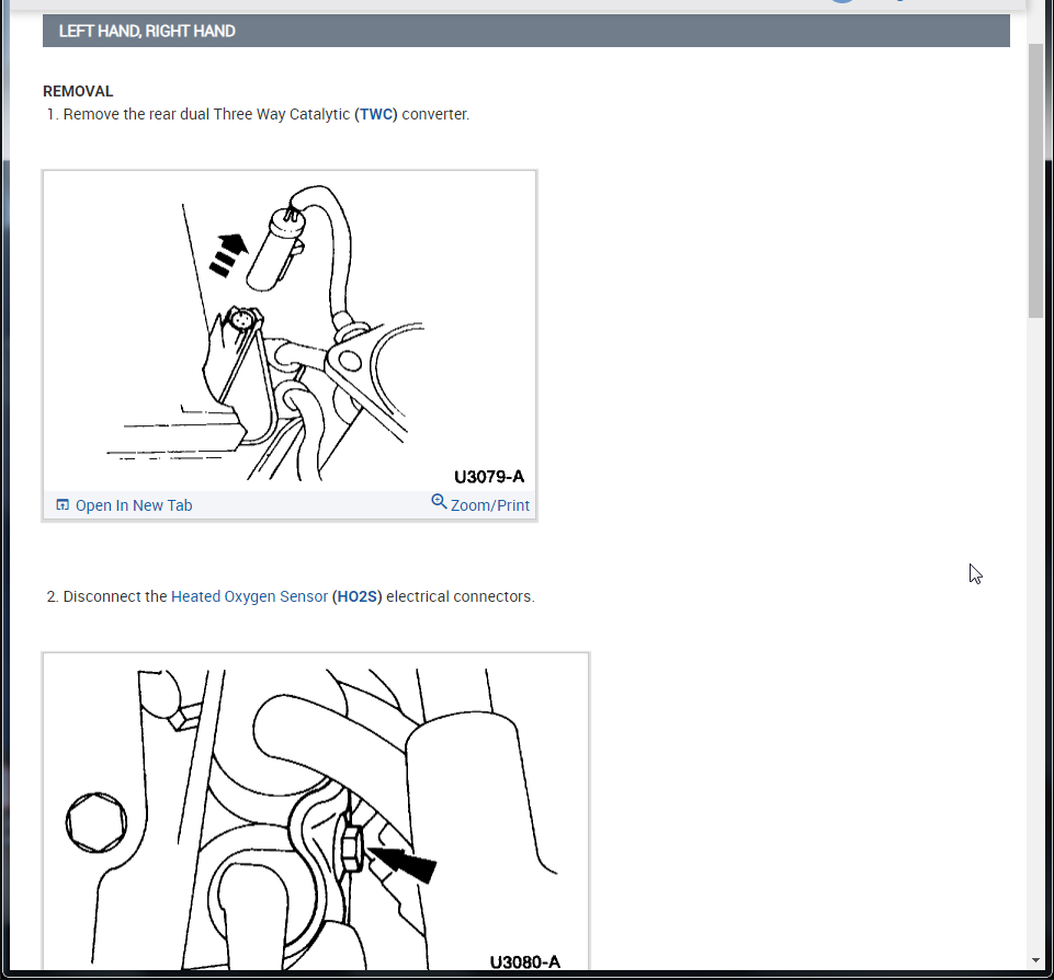

Hello, I need to know how to replace the catalytic converter, seeing how i'm not going to spend $600.00 to $700.00 on having someone else do it, need to know how to do it and what the process is. Thanks, Daniel P. Poindexter
Monday, July 28th, 2008 AT 10:45 AM
This is not a complicated repair. I attached the process for the manual. Take a look at it and let us know what questions you have.
Also, here are some guides that will give more information about this system:
https://www.2carpros.com/articles/catalytic-converter-replacement
Thanks
