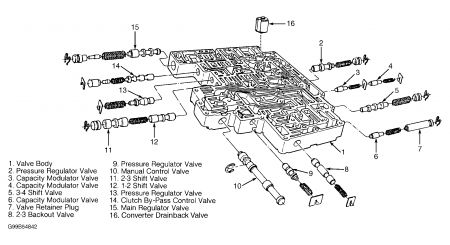

hi,
i am workin on a 96 explorer... its havin shift problems between 1st and 2nd... it pulled a shift soleniod problem... when i pulled the pan i saw 6 solenoids... just need to know which one should i change... thanks for any help

Hi: It is number 12 on the picture (1-2 shift solenoid). Let me know if this helps.
https://images.2carpros.com/forum/automotive_pictures/249084_5_32.jpg

Hi, Which number would be the shift solenoid C? Thanks

I don't know them by letters. If the problem is between 1st and 2nd, I would say number 12.
