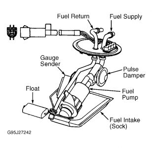

I wanted to know if you have instructions on installing an electric in tank fuel pump for a 1996 ford Explorer, 4.0 engine 6 cyl. 4 door, 4 wheel drive. Automatic Transmission.

FUEL PUMP Removal Release fuel pressure. See FUEL SYSTEM PRESSURE RELEASE under FUEL SYSTEM. Remove fuel tank. Using fuel tank lock ring wrench, carefully rotate lock ring counterclockwise to release pump. See FUEL TANK LOCK RING WRENCH IDENTIFICATION table. Remove fuel pump from tank. FUEL TANK LOCK RING WRENCH IDENTIFICATION ApplicationTool No. ExplorerT90T-9275-A Installation Wipe seal area of tank clean. Position new "O" ring seal onto pump, using grease to hold it in position. Position fuel pump in tank so fuel return hose is not kinked. Install lock ring. DO NOT overtighten pump lock ring, as it may leak. Install fuel tank.
https://images.2carpros.com/forum/automotive_pictures/266999_pump_5.jpg
