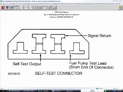

#12 fuse in the power distribution box is the fuel pump fuse 20 amp....so is the fuel pump relay I don't have a diagram but it's on the right fender apron under the hood, have some one turn the key to on and listen for the click of the relay...you need to turn the key off for a minute or two between tries...the owners manual should have the legend of this box in it!
https://images.2carpros.com/forum/automotive_pictures/62217_Test_Connector_Pre96_5.jpg
https://images.2carpros.com/forum/automotive_pictures/62217_Self_Test_Conn_1.jpg
Jump the pump test pin to the single wire connector that is with this connector, usually mounted on the left fender, this will test the pump circuit...

Hello , there This weekend we dismouted the fuel tank. it not zo easy , lots of wires. The fuel pump is the problem, it is jammed. Thanks for the information. Now i need to buy a new one and the problem is over i hope. but it is verry dum ore the way the fuel pump is installed, it.s on a verry dificult place. I am thinking to place an pump outside the fuel tank. But i don't no if that is possible, [/quote:ed9f5fe6fa]
Apr 13, 2008 at 3:53 PM
MERLIN2021
  • 17,250 POSTS
Those diodes make sure power flows one way only, test with continuity tester, should only work in one direction. First, drop the gas tank, unplug the connections, use a spanner wrench to remove the lock ring, or a hammer and BRASS punch. Pull out the old pump, dissconnect the wires, noting where the go, install new pump...reinstal lock ring, plug in the connector, install the tank! Try to remove all but about 1 gallon of gas, or the tank will be HEAVY!
