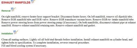

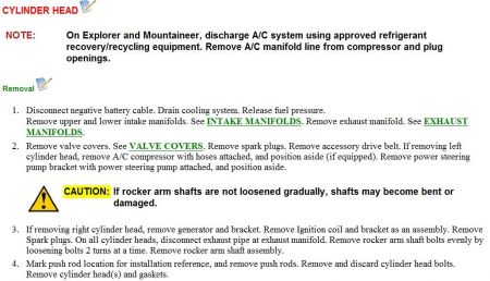

i need instructions on how to replace a head gasket. as detailed as possible would be appreciated.

The Ford Explorer was never equipped with a 4 cylinder motor as you have listed in the description.
I am not trying to be picky at all, but to ensure you get the proper procedures I will need the correct motor size. It is either a 6 cylinder , the most common, or an 8 cylinder.

it's a 6-cyl. its a 4.0 engine. my mistake.

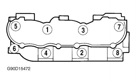

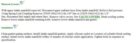

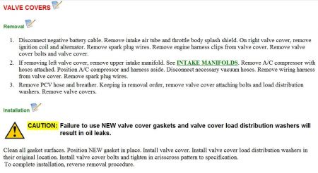

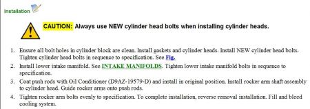

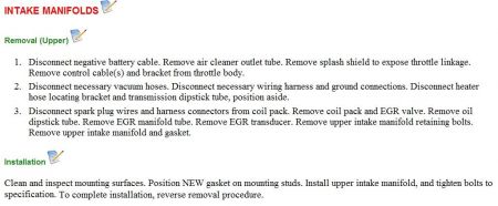

Thanks for that clarification. Below are the proper replacement steps for your vehicle's cylinder head gasket. If you need further assistance with this repair just let me know..
https://images.2carpros.com/forum/automotive_pictures/261618_Noname_2546.jpg
https://images.2carpros.com/forum/automotive_pictures/261618_Noname2_827.jpg
https://images.2carpros.com/forum/automotive_pictures/261618_Graphic_630.jpg
https://images.2carpros.com/forum/automotive_pictures/261618_Noname3_303.jpg
https://images.2carpros.com/forum/automotive_pictures/261618_Noname4_139.jpg
https://images.2carpros.com/forum/automotive_pictures/261618_Noname5_60.jpg
https://images.2carpros.com/forum/automotive_pictures/261618_Noname6_26.jpg
