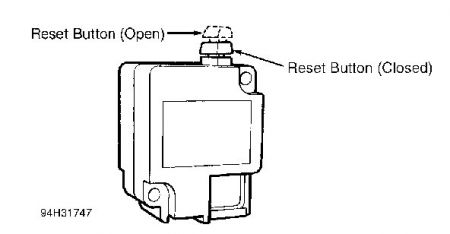

we have replaced the fuel pump, checked all the relays and fuses but I can not get the fuel pump to kick on at all checking wireing to make sure of power to pump. If thats good then i'm lost?

Check the inertia switch, it's behind the right front kick panel.

Did you check the inertia Fuel shut off switch?
LOL......was looking for a pic for 8 minutes on my HD.
https://www.2carpros.com/forum/automotive_pictures/30961_ifs_2.jpg
