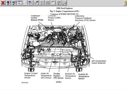

You have a coolant temperature sensor and a coolant temperature sender. Im not to positive as to which one handles the temperature indicator. I would assume the "sender" would I will send a diagram as to the location
Friday, March 5th, 2010 AT 4:35 PM
LEGITIMATE007
  • 5,121 POSTS
https://www.2carpros.com/forum/automotive_pictures/88091_temp_sender_1.jpg
+3
Friday, March 5th, 2010 AT 4:37 PM

No I dont believe your going to ruin your car, did you get my reply about the "sender" unit? Not the engine cooant temp sensor, but the sender unit?
Saturday, March 6th, 2010 AT 7:33 AM
DRAGYNAZ
  • 7 POSTS
Yes I actually changed both twice once from napa, and the second time I ordered them directly from ford, same situation nothing changed. Changed out my tensioner pulley assembley today seamed to help alittle bit, know its going from 184-202 not fluctuating as fast, but I noticed when I shut the car down my upper hose colapsed until I started it back up is this normal, asked an autoparts guy and he said it happens.
