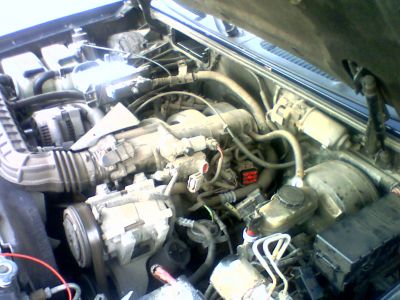

My ford Explorer 1995 wont shift out of park. Only way it does is if i put ignition in on position and put car in nutural and turn ignition on. My 13 fuse pops thats the fuse for my breaks. every time i change it and start the car and push the break it pops. Any idea whats causing this? I have tested the break switch thats fine. Looked at the speed control that works fine.

you need to remove the rear light lenses and look for chafed wires. also look under vehicle and see if it has a trailer hitch wire harness and make sure thats not melted.

Checked the Break Lights those seem fine, the break switch is fine the wiring to the switch seems fine.
seeing that it bundled to 40 wires hard to figure out where it goes bad.

Trying to follow the green wire - i cant follow it bc the dash board is in the way - do i have to remove that ?
That is one piece to the passeneger side :/

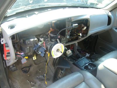

heres a picture of what i see.
https://images.2carpros.com/forum/automotive_pictures/171163_P1040795_1.jpg
https://images.2carpros.com/forum/automotive_pictures/171163_P1040793_1.jpg
Mar 22, 2008 at 7:33 AM
XELITEFORCEX
  • 13 POSTS
Went through all the wires - All were clear - i am totally lost now.
Thought tihs information would help
Before this problem came about i was trying to get on the highway off the off ramp and my rpms went to 6-7000 it wasnt shifting gears. so i pulled over in the break down lane and stop the car put it in break put it back in drive and waited 5 minutes than i went back about my buisiness and car worked fine. once i got to my gfs house, put it in park and went helped her came back to the car to go to walmart i stepped on the break and than i started the car and couldnt get it out of shift.

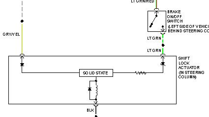

ok i just saw the shift interlock. its located on the steering column. it will have a light green wire a green and yellow wire and a black wire going to it. unplug that and see if the short goes away.
https://images.2carpros.com/forum/automotive_pictures/139033_br_1.jpg
Mar 23, 2008 at 12:09 PM
MASTERTECHTIM
  • 4,750 POSTS
ok unplug that that thing and see if the short goes away

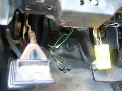

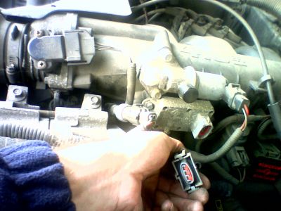

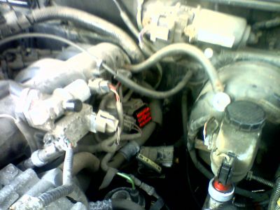

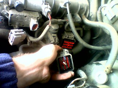

checked the hitch wiring did not find interlock thingy in the dash or around the steering column But i did find out a way to stop the fuse from popping and that has to do with disconnecting two plugs i took pictures can you guys tell me what i have disconnected and help me link it with the brake?
https://images.2carpros.com/forum/automotive_pictures/171163_Picture_4_1.jpg
https://images.2carpros.com/forum/automotive_pictures/171163_Picture_2_1.jpg
https://images.2carpros.com/forum/automotive_pictures/171163_Picture_3_1.jpg
https://images.2carpros.com/forum/automotive_pictures/171163_Picture_1_1.jpg
Mar 24, 2008 at 10:06 AM
MASTERTECHTIM
  • 4,750 POSTS
have you considered running a new wire from the brake switch to the rear of vehicle? eliminate the shorted wire all together.
Mar 25, 2008 at 12:08 PM
XELITEFORCEX
  • 13 POSTS
i took off all bulbs and cleaned all sockets changed a few bulbs. Pulled off all plugs under the hood and put them back in hit the car in many places including the computer box located under hood passenger side. so far the fuse has NOT popped and its been like 1 week

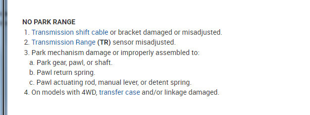

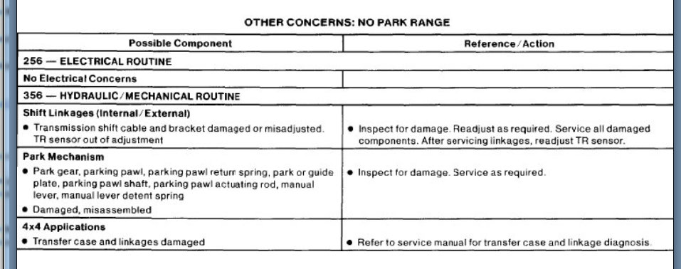

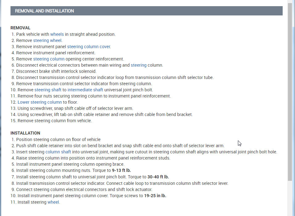

My explorer will not go into reverse or drive or neutral. In fact no gears at all. The shifter will move on the coloumn, however the tires wont move and the tranny will not engage at all. It is completely stuck. The truck will not move form its spot, I have tried putting it in 4x4 and nothing works. Got any ideas?
Jan 8, 2021 at 3:07 AM (Merged)
BRANDON SHARP
the shifting linkage could be the problem. it is located on the side of the transmission and goes op to the side of the engine that the steering stem goes through
This could be the shifter as mentioned or something more serious like a valve body issue. I attached the process below for the shift cable. I would suggest inspecting it and make sure that when you are moving the shifter that the manual level on the side of the transmission is moving as well. If it is, then we need to check the transmission fluid for condition and level. If this is okay, I suspect we are going to have to drop the pan to find out if there is metal in the pan and inspect the valve body.
Let's run through this material and go from there. Thanks
