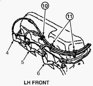

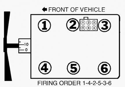

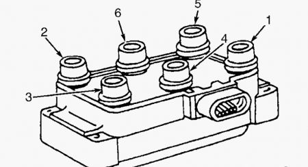

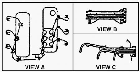

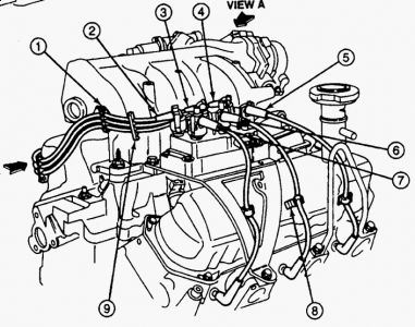

What sequence should the sparkplug cables should be?
