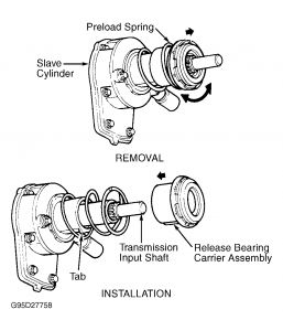

1995 Ford Explorer 6 cyl Four Wheel Drive Manual
how do i remove the throw out bearing from the slave cylinder
Nov 1, 2010 at 11:05 AM
DAVE H
  • 13,384 POSTS
CLUTCH RELEASE BEARING Removal (Internally Mounted Slave Cylinder) With transmission removed, twist release bearing and carrier assembly until resistance is felt. Turning assembly further will allow preload spring to push bearing assembly from slave cylinder. See Fig. 6
