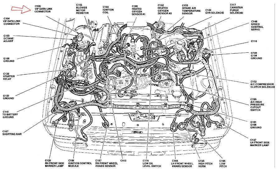

1995 Ford Explorer 6 cyl Two Wheel Drive Automatic
Where is the on board diagnostics located on 95 ford explorer
Mar 10, 2009 at 1:44 PM
  • 55,851 POSTS
Hello!
Here is a diagram and guide on how to get the codes and where the connector is so you can get the problem fixed.
https://www.2carpros.com/articles/ford-lincoln-mercury-obd1-1995-and-earlier-diagnostic-trouble-code-definition-and-retrieval
if its obd2 its under the dash on the drivers side.
Please let me know if you need anything else to get the problem fixed.
Best, Ken
