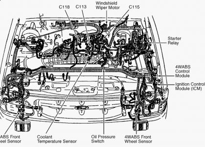

in the end of the day, we checked the sprk and it is missing
Sep 12, 2009 at 1:46 AM
MERLIN2021
  • 17,250 POSTS
Check for power at the coil (+) connection.if there is power there, then remove the ignition mudule, take it to the parts store they can test it b$ you buy a new one. Left front of vehicle.
https://images.2carpros.com/forum/automotive_pictures/62217_ICM_2.jpg
