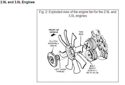

https://www.2carpros.com/forum/automotive_pictures/170934_ford_explorer_fan_1.jpg
Hope this helps?

Removing the fan can be a pain. You need to have a big adjustable wrench and 10mm most likely. Take 3 bolts out of the pulley. You are going to use the remaining bolt to hold the pulley in place with the 10mm. Be carefull some models have the clutch nut threaded counter clockwise.
