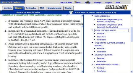

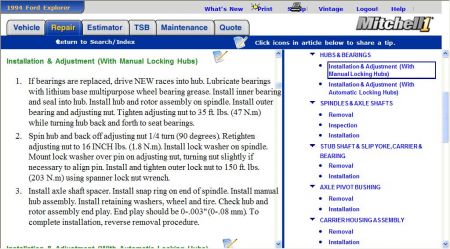

I was told that the front Hub bearings are loose. The mechanic was nice enough to tell me I could do this myself. My question is how do I do this?

You need a torque wrench and correct size socket and follow the prodecures below-
https://images.2carpros.com/forum/automotive_pictures/12900_axle1_1.jpg
https://images.2carpros.com/forum/automotive_pictures/12900_axle2_2.jpg
