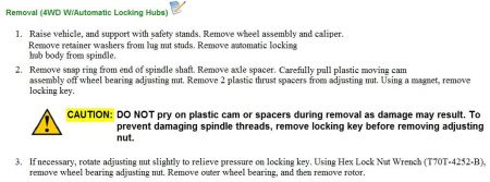

1994 FORD EXPLORER
1994 Ford Explorer
how to remove rotors
Thursday, July 22nd, 2010 AT 4:25 PM
3 Replies
BLUELIGHTNIN6
MECHANIC
16,542 POSTS

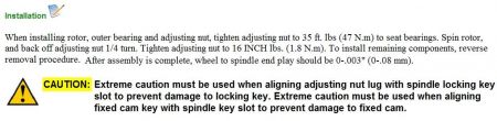

To better assist you with this repair I would need to know if this is on a 2WD or 4WD Explorer, if it is 4WD does it have automatic or manual locking hubs?

4wd, automatic
