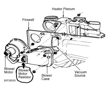

My switch for the heating temp. is not working, it was working fine a couple days ago on max but no other temp. I have changed the switch, blower, checked wires, changed fuses, and relay switches but there is still no air blowing, wondering what it is that i am missing?

check the blower motor resistor !
https://images.2carpros.com/forum/automotive_pictures/266999_res_4.jpg
