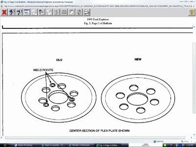

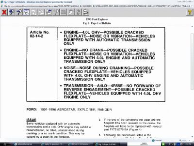

If you have the 4.0 OHV engine, it may be a cracked flexplate! There is a TSB on the Explorer with the above engine!
Mind you it a possiblity to look into, and will save a boatload of money! Can be other things too!
https://www.2carpros.com/forum/automotive_pictures/62217_91Flex_1.jpg
https://www.2carpros.com/forum/automotive_pictures/62217_91Flex1_1.jpg
