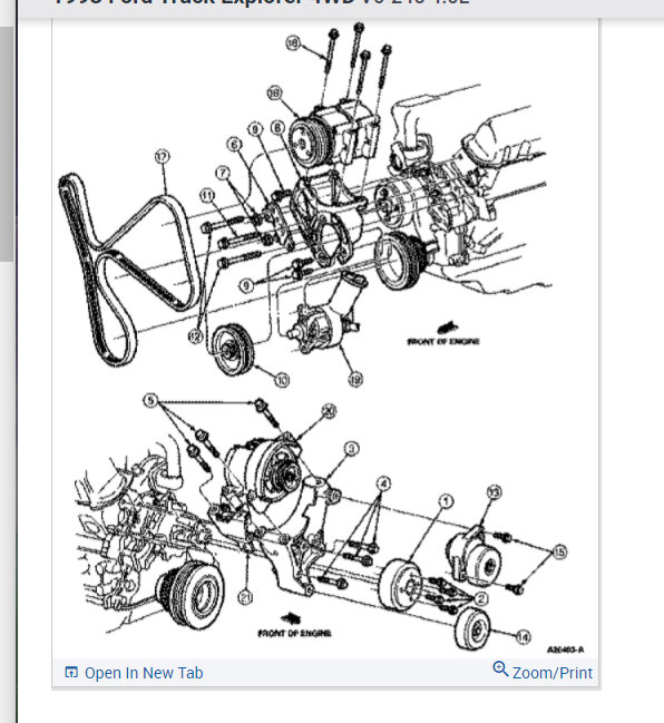

Is there a web site or can you give me directions (hopefully with pictures) for removing and installing a water pump on my 1993 ford explorer 6 cylinder 4 wheel drive?

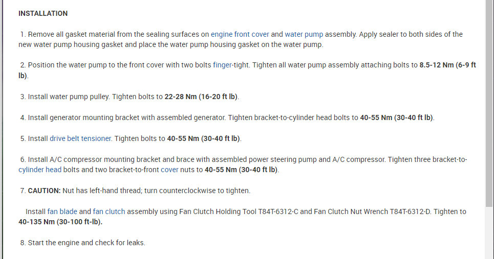

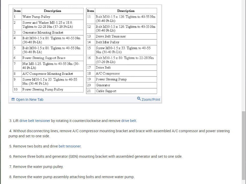

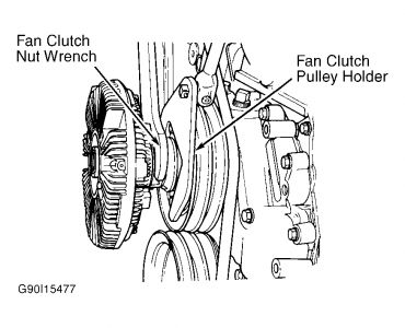

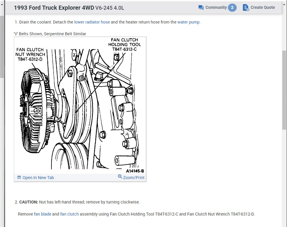

However, below you will find the process from the manual which will include the torque specs that you need to complete this.
Please run through this and let us know if you have other questions.
