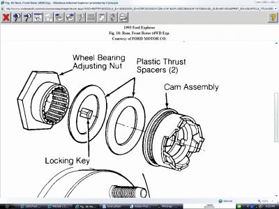

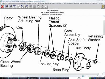

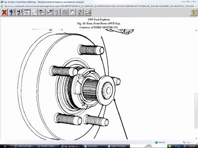

Is ther a trick to removing the rotors, they wont just pull off. Is there a bolt or something that has to come off or do I just keep pulling?

I use a magnet to remove the locking key, use car when pulling off the plastic piece!
