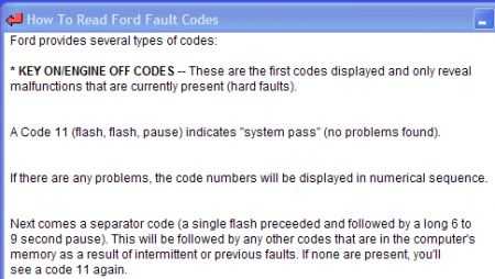

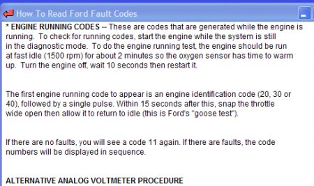

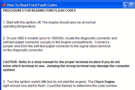

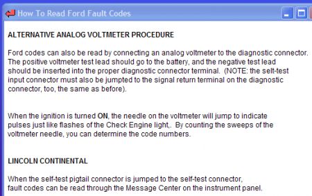

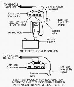

Is the check engine light on? Try reading the codes this way: Do this and count the flashes...Count the flashes, a 22 will flash as 2 flashes then a short pause, then 2 flashes, if more than one code is stored, the pause will be longer. The codes will display three times and end with 11 or 111. Write them down and post here. First do this with the ke on engine off, then again with it running.

OK I need to look all this up and see what it means, but you either use the check engine light on the dash, or a voltmeter with a needle(analog).
https://images.2carpros.com/forum/automotive_pictures/62217_1_22.jpg
https://images.2carpros.com/forum/automotive_pictures/62217_2_22.jpg
https://images.2carpros.com/forum/automotive_pictures/62217_3_23.jpg
https://images.2carpros.com/forum/automotive_pictures/62217_4_12.jpg
