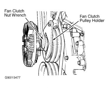

How do I get the fan pulley assembly off so I can change the water pump??

There is aspecial set of wrenches made to do this. One holds the fan pulley and the other fits the nut on the clutch fan. The threads are left hand, so to loosen turn clockwise as viewed from the front of the engine
https://images.2carpros.com/forum/automotive_pictures/1639_ford_3.jpg
