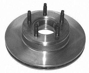

1991 Ford Explorer V8 Four Wheel Drive Automatic
How do I pull the rotor off! Do I have to mess with the axel or four wheel drive locking assembly or just simply hit the rotor off

You have to remove the locking hub, the axle nut bearings and all. Make sure you re-pack the bearings, and replace the seal.
