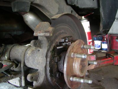

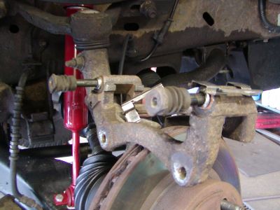

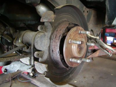

2003 Ford Experdition 99,000 5.4L what tools are needed to install rear pads and rotors

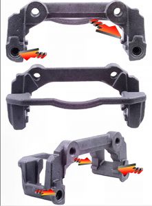

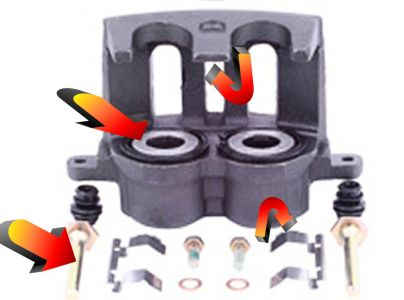

https://images.2carpros.com/forum/automotive_pictures/30961_caliper_lubeareas_6.jpg
https://images.2carpros.com/forum/automotive_pictures/30961_caliper_lubeareasbrack_6.jpg
[img] Don't forget the love lube. :D
https://images.2carpros.com/forum/automotive_pictures/30961_caliper_lube_7.jpg
Be prepared to have to remove the e-brake pivots and possiblely the e-brake shoes and hardware.
https://images.2carpros.com/forum/automotive_pictures/30961_PA080026_1.jpg
Clean the clips on both sides:
https://images.2carpros.com/forum/automotive_pictures/30961_PA080031_1.jpg
Pivots:
https://images.2carpros.com/forum/automotive_pictures/30961_PA080034_1.jpg
