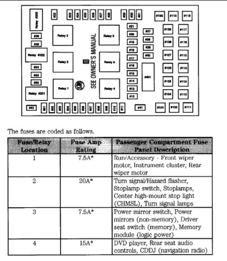

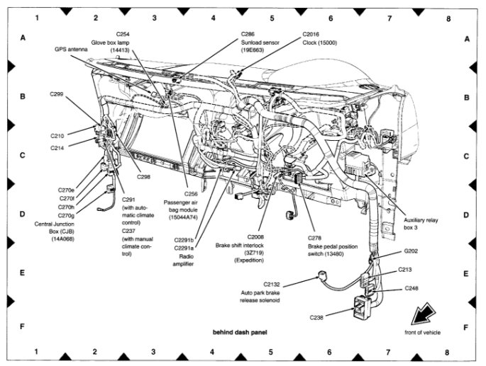

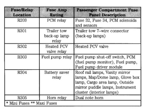

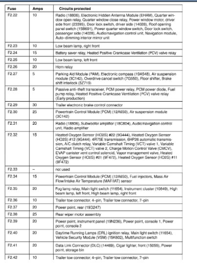

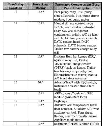

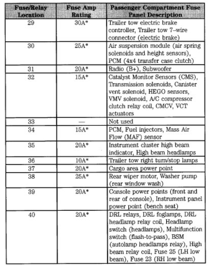

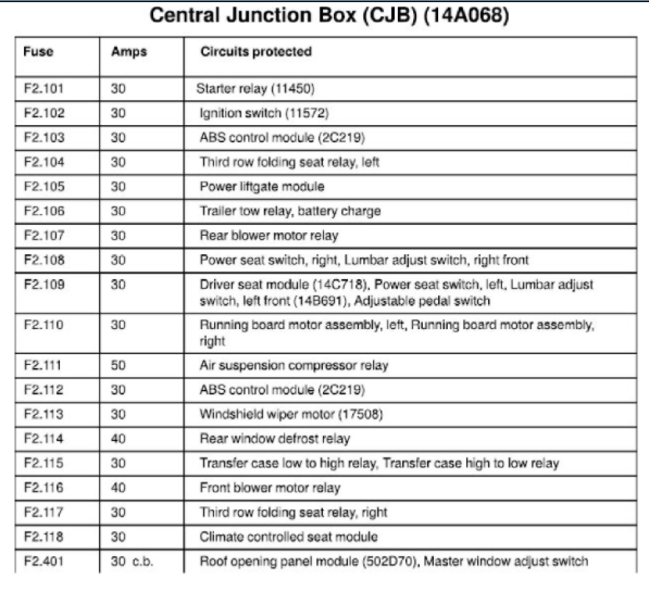

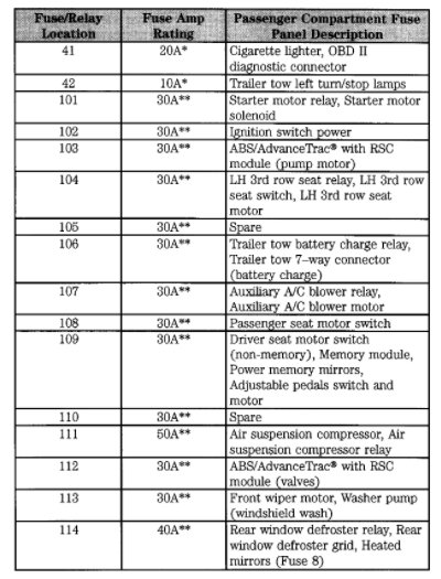

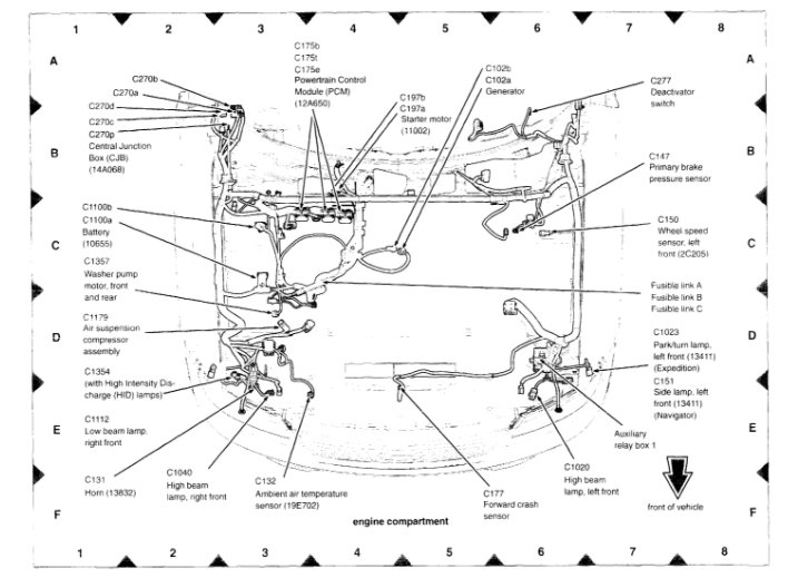

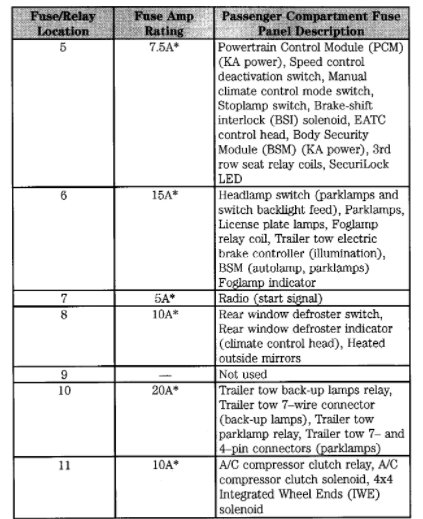

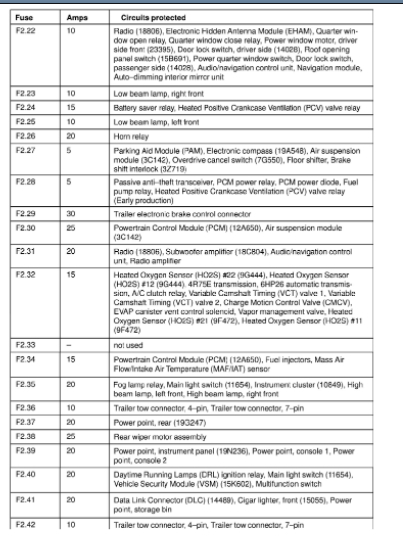

Truck is rough to start and engine light just came on. It seems like a got some fuses out can you show me where to look and how to check the fuses?
Monday, October 27th, 2008 AT 8:57 PM
DANNY L
  • 5,648 POSTS
Hello, I'm Danny.

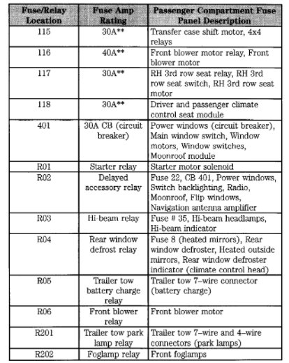

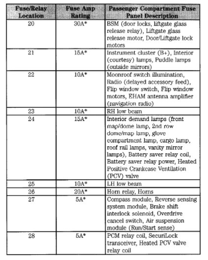

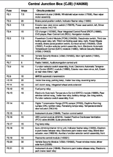

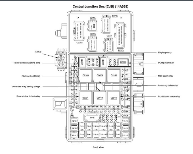

Here is the information you requested. Here are a few tutorials for you to view on how to check and replace fuses:
I've attached pictures below showing the fuse and relay locations on your vehicle. Hope this helps and thanks for using 2CarPros.
