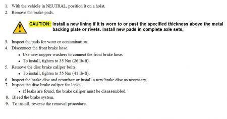

What tool do i need to remove the front brake callipers?
Oct 21, 2010 at 7:25 AM
BLUELIGHTNIN6
  • 16,542 POSTS
https://images.2carpros.com/forum/automotive_pictures/261618_Noname_2816.jpg
