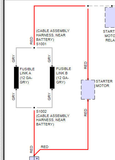

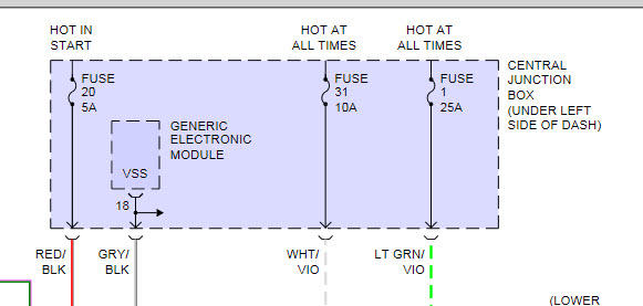

If I turn the key everything lights up like normal but nothing happens with the starter. If I turn it to run and touch the points on the selenoid it starts right up and runs fine so I was thinking it was the neutral safety switch but the radio doesn't work at all. I don't think the ignition and radio share a fuse but I checked all the fuses that say radio or ignition and they looked okay but the fuse box layout in the owner'sanual doesn't match the one that exists. Any ideas?
Aug 8, 2019 at 7:06 AM (Merged)
HMAC300
  • 48,601 POSTS
try resetting your security system first if no manual look online. pictured are fuses for radio but it may be the gem module bad so have it scanned. could also be an ignition switch. also check the fusible link s in second pic they could also be the problem.

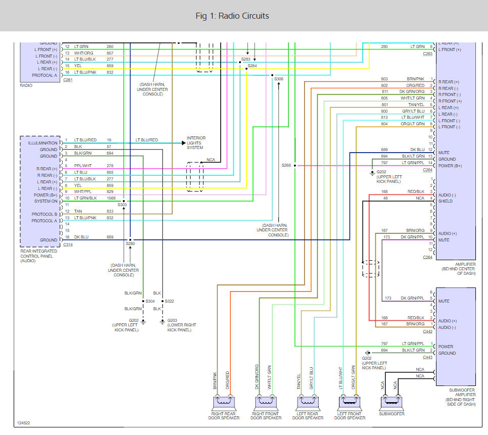

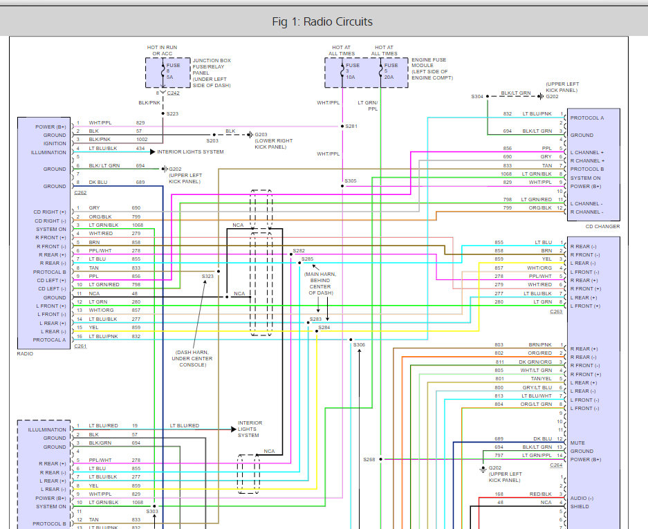

Electrical problem V8 Two Wheel Drive Automatic 282000 miles
I Just put a new stereo in my Expedition but there is no sound, Im being told it's because of my amplifier something to do with it needing to be turned on.
Im not sure, I was not explained it to very clearly.
My problem was that no sound was coming from any speakers due to the amp not being turned on by my new stereo, Im assuming that all the speakers in the car are turned in by this amp?
Anywho what I tried doing and work was takeing the amp wire and plugging it into the wire coming from the stereo called a remote wire.
It turns on my amp and gave me sound!
I just need some advice, tip's or help of some kind please!!
  • 55,628 POSTS
Yep the amp needs to see a trigger from the new stereo. Use the antenna trigger (blue wire I believe) and connect it to the amp trigger wire which I have for you in the wiring diagrams below. Its the dark blue wire that goes to the amp.
Please let us know what happens so it will help others.
