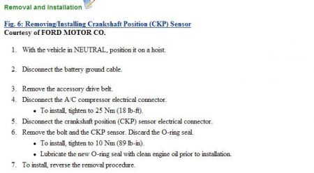

Hi There.
Hoping for some quick help. Dealer wants a lot of money for what seemingly looks like a simple job, CrankShaft Sensor Replacement. While positon of the sensor is not easily accessible, it looks like a job i can complete on my own; however, i don't have a repair manual and am seeking guidance for completing the task of replacement. From my view, a single bolt is removed, the sensor is pulled, clean the area well, lightly oil the seal on the new sensor and replace. Is this correct? Do i need to drain the oil? Any torque specification for the bolt?
Thanks,
Ray
Feb 10, 2009 at 5:51 PM
BLUELIGHTNIN6
  • 16,542 POSTS

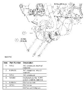

Hello Below are the proper replacement procedures for your vehicle's crankshaft position sensor.
https://images.2carpros.com/forum/automotive_pictures/261618_Noname_234.jpg
FIGURE 6
https://images.2carpros.com/forum/automotive_pictures/261618_2_9.jpg
