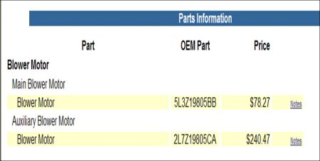

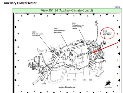

When we turn on the A/C or heater blower for the back seats a very loud and pronounced thumping/knocking sound can be heard coming from the passenger side rear quarter panel. I'm thinking that there may be a blower unit inside the rear panel, but I'm not sure. What's the problem and how can I fix? Is the part avaiable from a parts store or is this a dealer required fix?

Hello - You are correct based off of the information I am looking at. There is a blower motor in the back. Not knowing your level of mechanic ability is hard to say if you are able or not. I feel, general basic knowledge is okay for this. It seems to be removing the interior trim panels and locating the blower motor. There may be something hitting the fan or it may have come loose.....the squire cage part Me, I would first remove the panels and get to it to see what was the matter. It may be something very simply. If you do have to replace the fan, I have attached two different OEM parts/prices for you. Boy, it had to be the rear............that one is a little more pricy than the front. I would definitely check auto part stores. But then again, you may get in there and see you don't need anything. I have also attached a TSB on the subject of hearing noises back there. The noise you describe doesn't look like this, but wanted you to review for yourself. I have also attached a pic of the blower.
