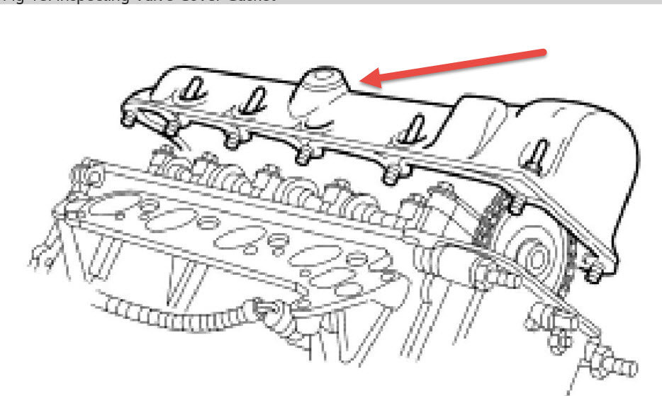

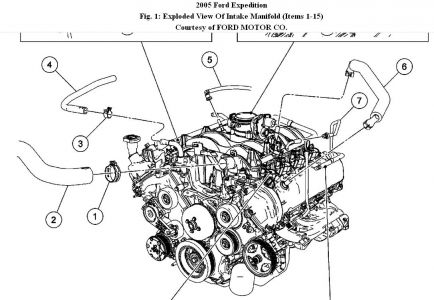

I am looking to put in an oil catch can pcv valve location please?
Nov 3, 2010 at 7:47 AM
KHLOW2008
  • 41,814 POSTS
Hi cldchln, 2005 Ford Expedition and 2007 F150 are similar. Item # 6 is the PCV hose. The valve is plugged into the valve cover.
https://images.2carpros.com/forum/automotive_pictures/192750_IntakeManifold05ExpeditionFig01_1.jpg

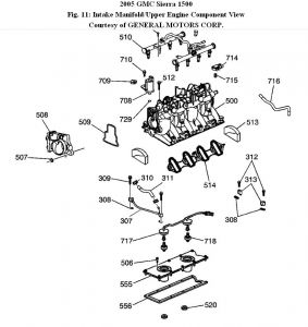

2005 GMC Sierra 1500. PCV hose is item # 716, (dirty air ) and # item # 700, (fresh air).
https://images.2carpros.com/forum/automotive_pictures/192750_IntakeManifold05Sierra53Fig11_1.jpg

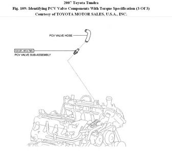

2007 Toyota Tundra
https://images.2carpros.com/forum/automotive_pictures/192750_PCV07TundraFig109_1.jpg

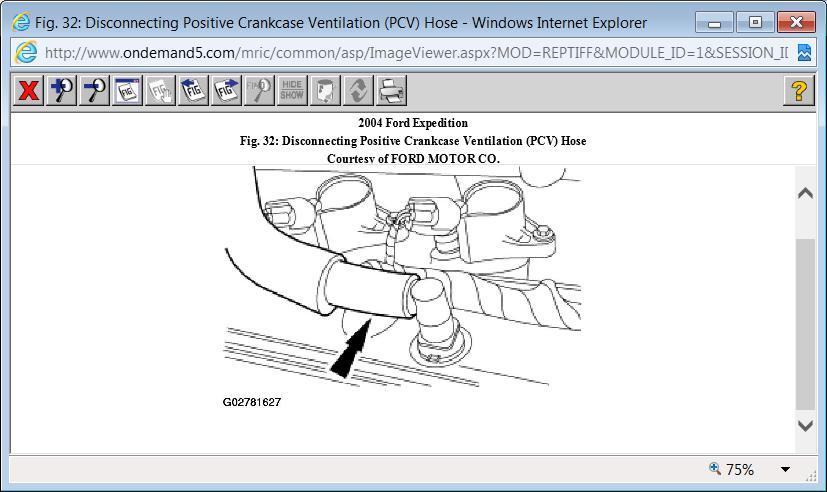

Where is the pcv valve location in a 2004 4.6 ford expedition
Sep 12, 2019 at 7:43 AM (Merged)
HMAC300
  • 48,601 POSTS
in the valve cover rh side see pic

Can you send me a pic of the pcv part that I need to purchase. Also I've looked everywhere trying find the location where I need to replace the valve doesn't look the same as the diagram in my vehicle. Is there another truck thats compared to the 2004 4.6 ford expedition has the same location

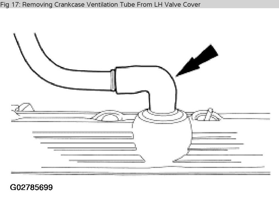

HMAC300
  • 48,601 POSTS
see if these help you the pcv may unscrew for removal on LH side of engine (driver's side)

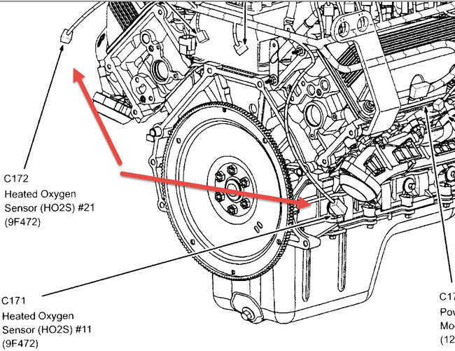

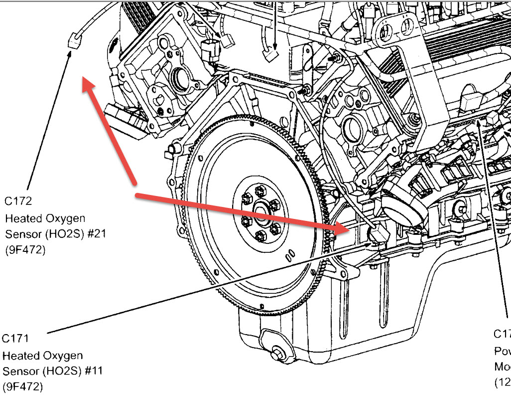

Thanks again. Another question I have can you also send me a diagram of where my upstream oxygen sensors are located in my 2004/ 4.6 expedition
HMAC300
  • 48,601 POSTS
they are the ones between engine and converters on exaust system.see pic. please repost a new question like this as a lot of times they are not answered

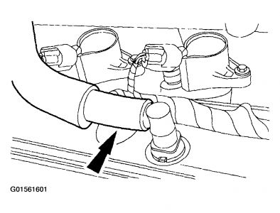

MELISSA1001
Is the valve located under the plastic cover or on the driver's side of the cover, just below? I asked the person at an automotive store but they were unsure of it's location. A picture would be helpful.
SATURNTECH9
  • 30,869 POSTS
The PCV valve is located in the upper portion of the valve cover. Here is a diagram of the 4.6L or 5.4L engines below.

KIMMY4400
  • 5 POSTS
Thanks so much I appreciate your help. The second diagram was a lot more accurate

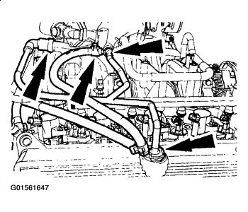

BIGLEE33
I would like to know exactly where my pcv tube is located and if it will be difficult to replace for the user.
  • 110,244 POSTS
What size engine do you have?
BIGLEE33
I have the 4.6 Liter.

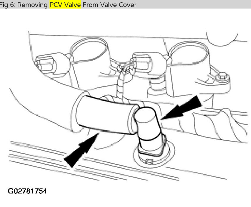

  • 110,244 POSTS
Here are the pictures I found. It is on the valve cover.
https://images.2carpros.com/forum/automotive_pictures/249084_PCV_1.jpg
https://images.2carpros.com/forum/automotive_pictures/249084_pcv_v_1.jpg
Let me know if this helps. NOTE: These pictures are from Ford, so I will assume they are correct.

ELLIOTT37
bought a pcv vave and cannot find it on the engine
  • 110,244 POSTS
Hi: It's located on the valve cover. Here is a picture.
https://images.2carpros.com/forum/automotive_pictures/249084_pcv_2.jpg
Let me know if this helps. Joe
