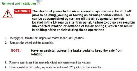

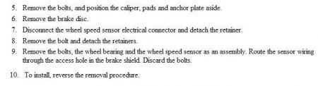

How do I remove wheel hub and bearing from the right rear? I removed the wheel, caliper, disc and 4 bolts from rear. I can't figure out how to get the hub off.

https://images.2carpros.com/forum/automotive_pictures/261618_Noname_1493.jpg
https://images.2carpros.com/forum/automotive_pictures/261618_Noname2_440.jpg
