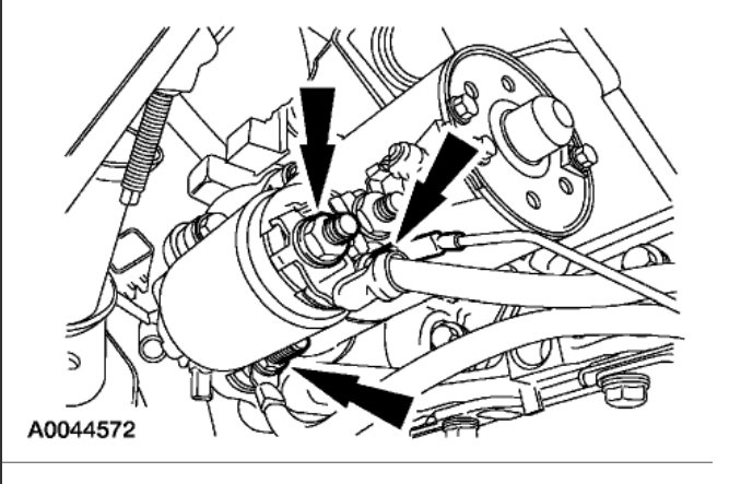

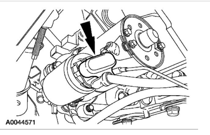

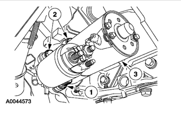

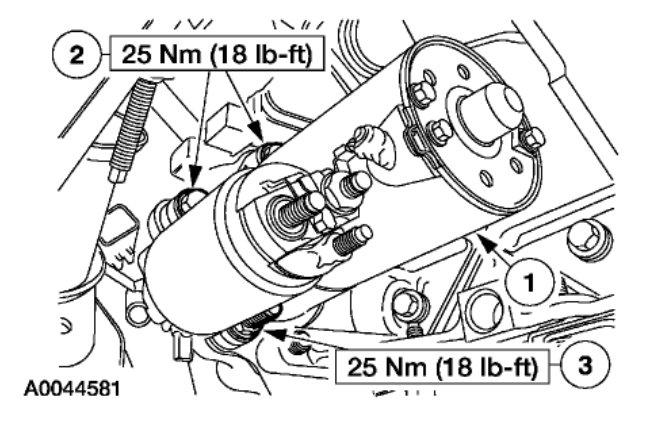

It sounds like it could be the starter bendix return spring is broken and hitting the flywheel. I would remove the starter and check it out.
Here is a guide
Here is what it will be like for your car (below)
Cheers

No noise on startup, It ONLY happens when the car is warmed up and is accelarating or going up a hill..
Jul 30, 2009 at 12:23 PM
MERLIN2021
  • 17,250 POSTS
Yep that is when the bendix is forced into the flywheel to make the noise becasue the spring is broken.

No there is no sagging of any kind. Did notice now that the front end is out of alignment. They are having a tough time figuring it out until they removed the starter and BAM! you were right :) I am so happy thanks 2carpros!
