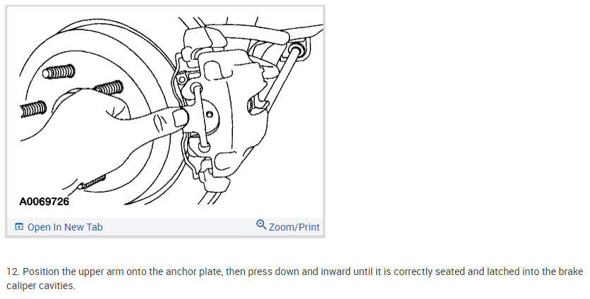

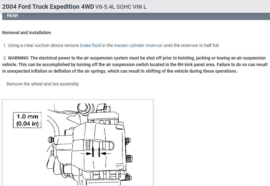

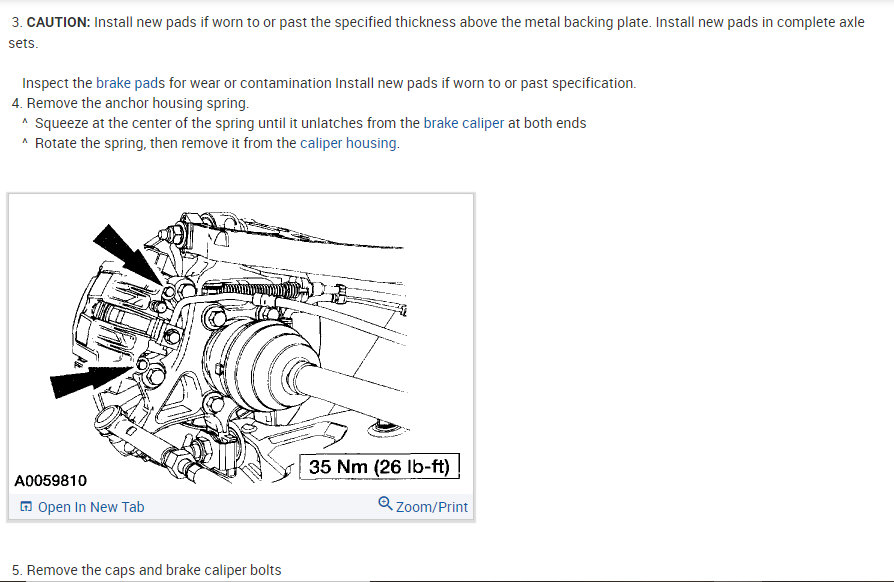

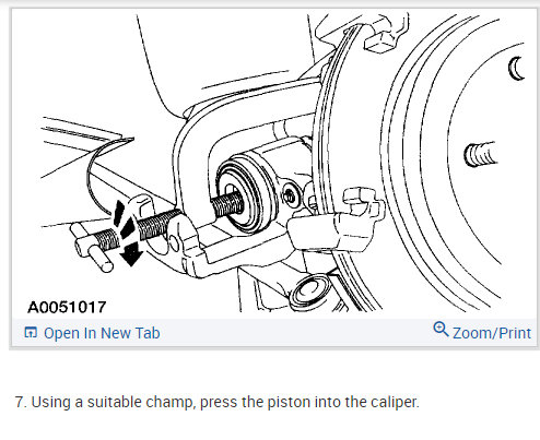

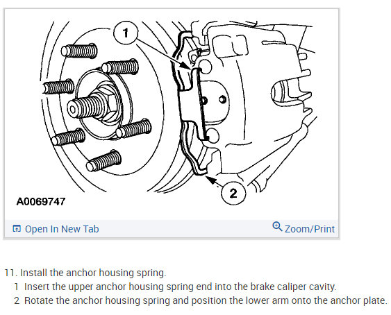

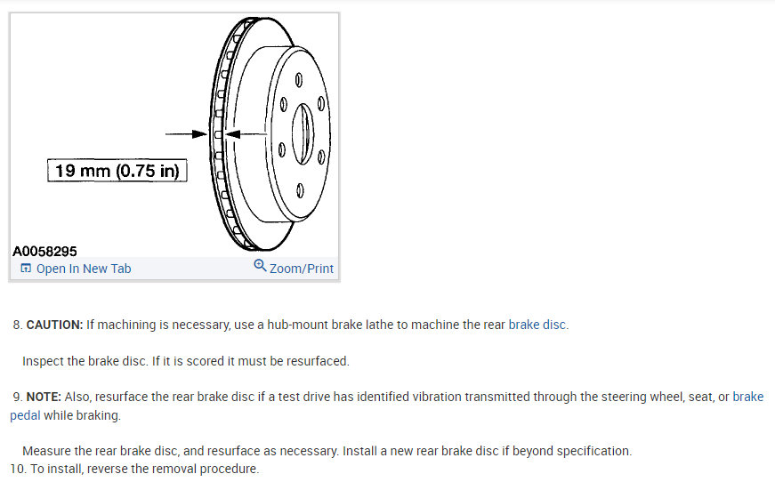

Hello, I'm Danny.
I've attached a tutorial for you to view showing how to replace the rear pads and rotors.
https://www.2carpros.com/articles/how-to-replace-rear-brake-pads-and-rotors
Here is a YouTube video from our site for you to view on how to retract the rear caliper piston:
https://youtu.be/j8YwfSKEzZo
I've attached picture steps below on how to replace the rear brake pads on your vehicle.
