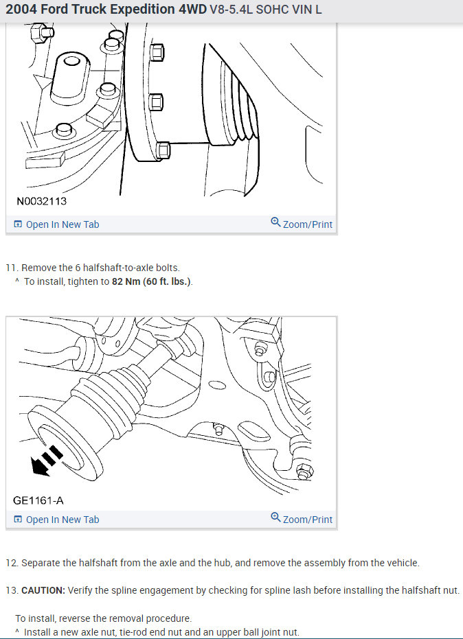

When we drive, it sounds like a grinding or scraping noise coming from the left front side. The noise is louder when we turn the wheel to the right. We changed the hub assembly and rotor but the noise continues. what could be the possible reason for the noise. The noise doesn't seem to be getting worse. Can we be causing more damage? This is our only vehicle.

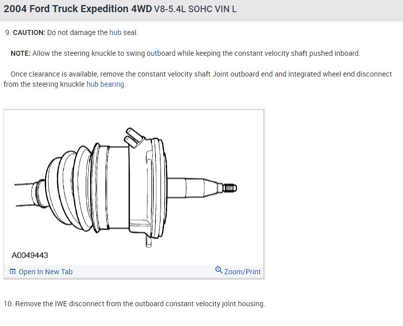

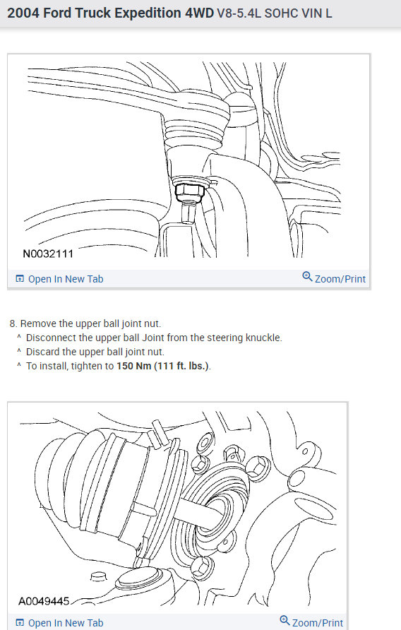

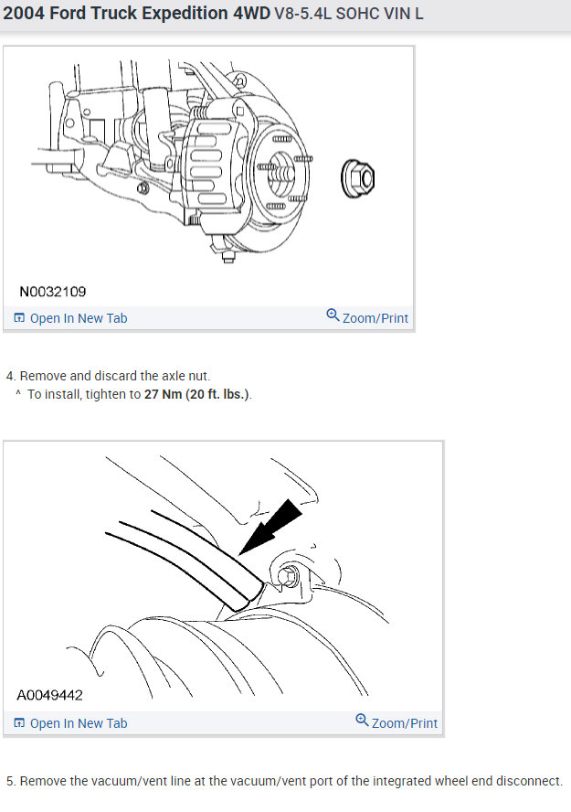

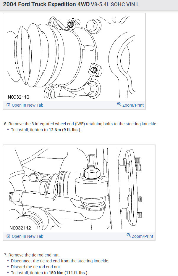

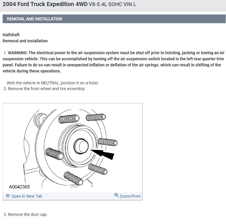

That noise is probably coming form the half-shaft.
If the boot on that shaft leaks, it will allow dirt and derbies to enter the joint.
This will make clicking/scraping noise. That noise typically intensifies when you turn.
Inspect the half shaft. If it is leaking you will have grease all over suspension components.
Here is a helpful article on replacement of the shaft:
https://www.2carpros.com/articles/replace-cv-axle
