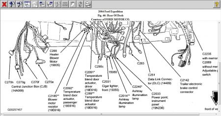

1st- rear wiper doesn't work. Motor good. Where is rear wiper control module.
2nd- blower only blows on high. Where is relay

Hi Mauro08036, and TY for the donation
Answer to no.1 ?
Check and test fuse no.1 10 amp and fuse no.38 25amp, also test the rear wiper motor relay in the liftgate rear motor wiper assembly.
https://www.2carpros.com/forum/automotive_pictures/12900_wiper_2.jpg
For no.2
The blower motor resistor controls the speed of the blower motor its located behind the center of dash.
https://www.2carpros.com/forum/automotive_pictures/12900_blower_motor_resistor_14.jpg

#1- fuses are good and I install new motor. Still nothing. Rear washer doesn't work either.
#2- can you send a larger verison of both diagrams because I can not see at all? Is resistor easy to get to?

Disregard what you've seen when you came back its not your answer. Give me your email addy and I'll try to buff it up.
BTW it sounds like the microprocessor is defective which is located within the liftgate rear motor wiper assembly.
