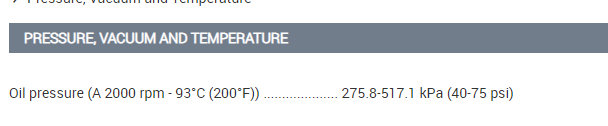

Vehicle has low oil pressure.
Monday, June 21st, 2010 AT 7:05 PM
This could be a couple possible issues.
First it could be a faulty sensor. Second it could be low pressure.
Here is a guide that talks about this:
https://www.2carpros.com/articles/high-or-low-engine-oil-pressure

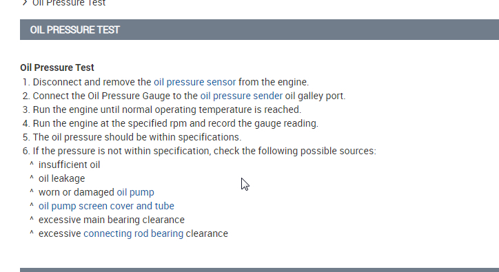

We need to hook a mechanical gauge up to the engine and find out if the gauge in the cluster is correct. I attached below the instructions on how to do that from the manual.
Let's run through that and see what the actual pressure is. I also attached below the spec for the oil pressure and the location for the sensor. Thanks
