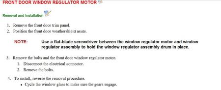

how you take the window motor out, to be replaced

https://images.2carpros.com/forum/automotive_pictures/261618_Noname_2585.jpg
