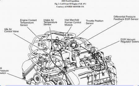

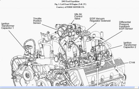

how to fix this is it expensive? will it be cheaper to have it done at ford dealer ?
Mar 20, 2009 at 7:47 AM
MERLIN2021
  • 17,250 POSTS
Almost nothin g is cheaper at the dealer, most IAC's are under 100.00 at the parts store, it depends on which engine you have 5.4 2V or 4V here's the pictures. 2 small bolts and a gasket is all there is to it...
