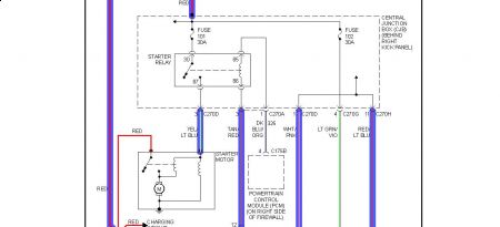

I am having a problem with my vehicle. I thought that maybe it was the battery but I got one of those free battery checks at Auto Zone and it turns out that that is not the issue at hand.
Let me explain briefly what is going on. Sometimes when I go to start my truck it just clicks, Sometimes It will make a sound like it's going to turn over but it doesn't and then it clicks and then other times it will start over and over again for up to a week before the issue will once again arrive.
I have to always keep jumper cables on me and back into every parking space at a store just in case it will not start and I can easily be accessed to receive a jump.
I have no idea what's going on and My husband is baffled as well. I'll tell you one thing tho, between having 4 children, one on the way and scraping by on a budget, we can't afford to take it in for a check up.
I would appreciate anything that you can tell me at this point. I am at a loss and to top it all off, the car is not even yet payed for.

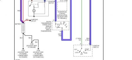

Check fuse no. 101 30amp and fuse no.102 30amp if both okay -do below You hold key to starting position at all times have hubby tap on the starter a few times-if it kicks over -the problem is coming from the starter. No engagement-check for power at the starter relay socket terminal 86 with tan and red wire on it and also at the transmission range sensor-No power at both -you have a bad ignition switch or the starter relay-try swapping the starter relay with a known good one and see what happens. Let me know
