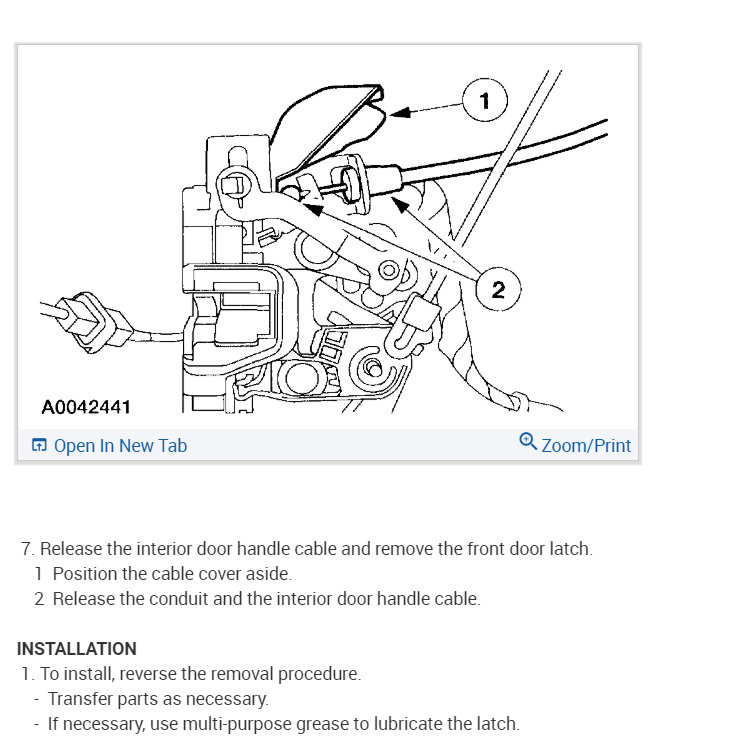

I was told that the dirty door sensors are causing the vehicle to think that the door is ajar. How do I fix this problem or eliminate the noise alert, it is non-stop.

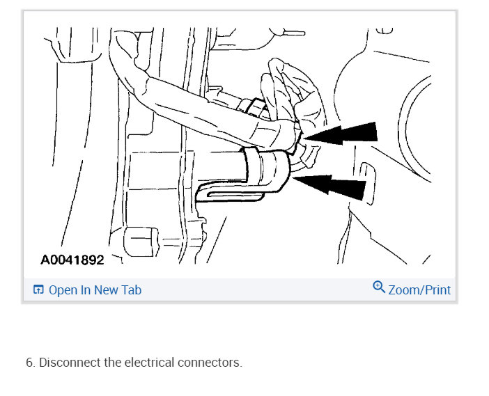

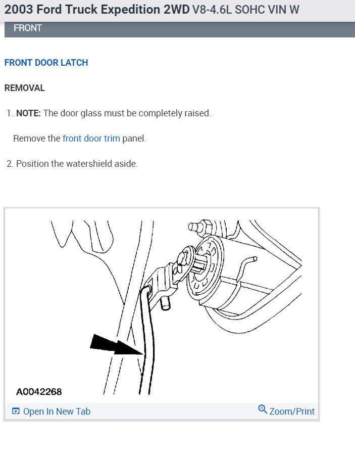

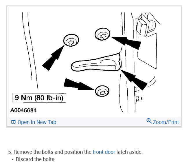

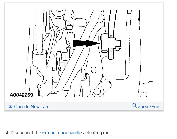

The switch is part of the latch assembly on your vehicle. You need to remove the door panel to access it. At that point you can check to see if the switch is bad or dirty. Here are diagrams below to help you change it out. Check out the diagrams (Below). Please let us know what you find.

stuck or faulty door ajar switch most likely culprit. lubricate all door latches including rear hatch with WD40 to see if it will loosen the switch.

Chances are one of the roll switches on the door is bad and not stopping the power to the system. You need to disconnect them one at a time to see which one is the problem. I would recommend starting with the driver's door. Also, make sure the rear hatch and window are closed tightly.
