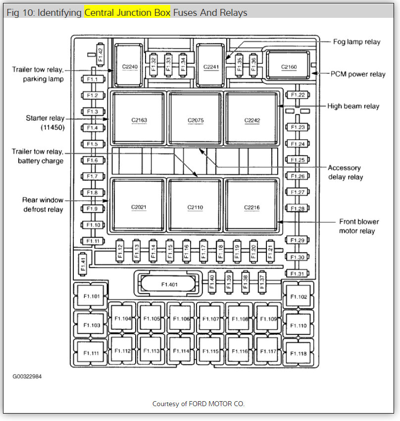

my vehicle was recently in storage for 2 month and my battery died. i jump started it and all was fine.4 days later the vehicle shut down. check charging system! i check the alternator and replaced the battery no joy!! can anyone assist me ?

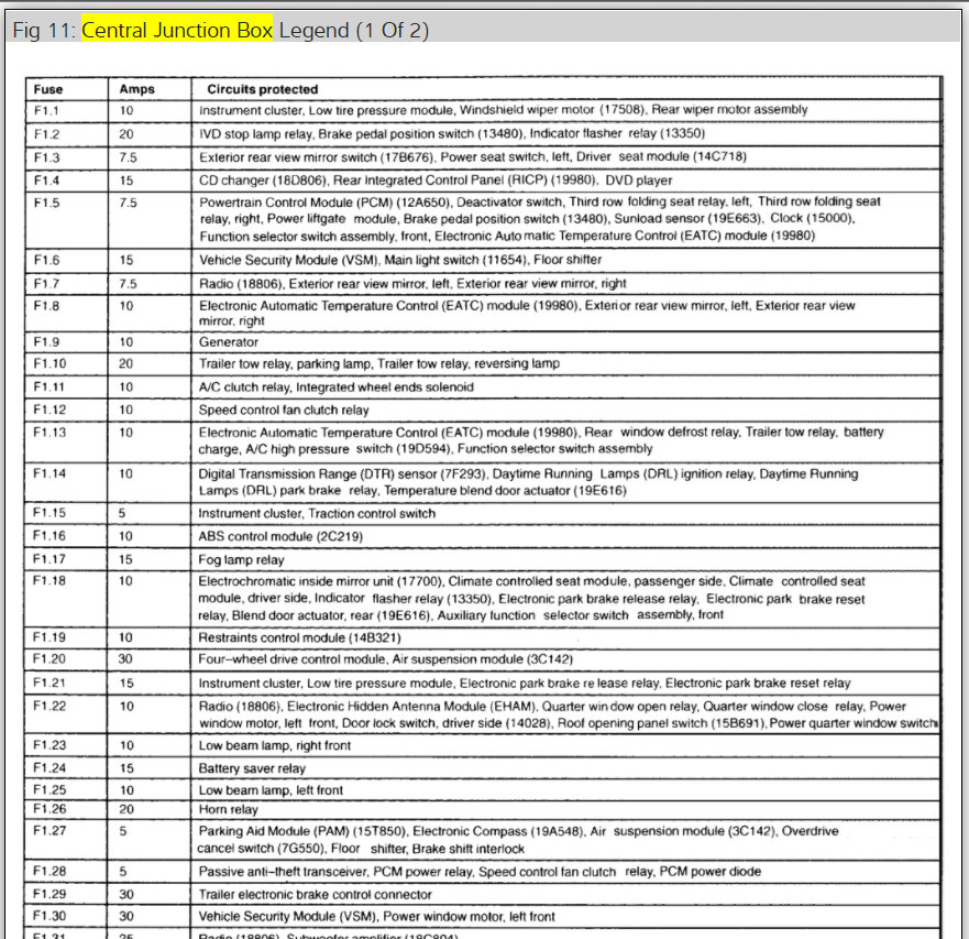

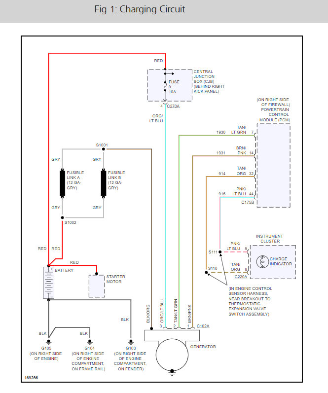

There is a fuse #9 that needs to be checked because it it is blow the system will not charge. here ia guide and the alternator wiring diagrams so you can see how the system works and the fuse location with a guide to help check it as well.

[quote:164ff84cc4="legitimate007"]what did you find when you checked the alternator?[/quote:164ff84cc4]
The alternator is good. Both test good alternator and battery

check wiring for a bad connection this guide will help.

I found the connector to the alternator has bad I replaced it and everything started working again. thank you
