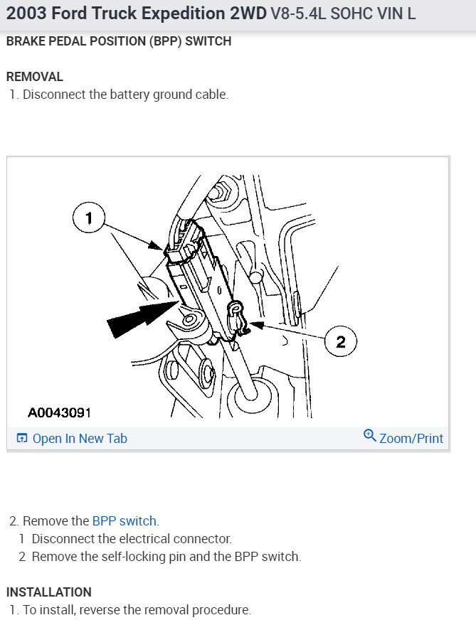

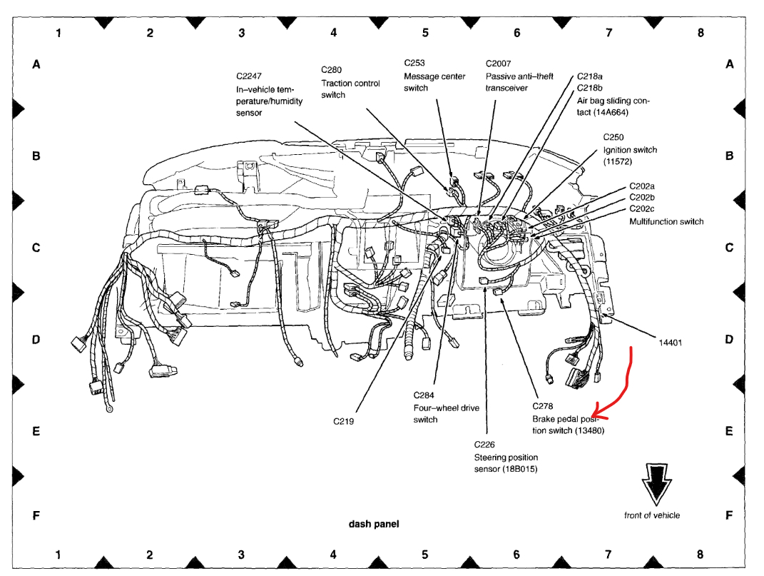

If the fuse is okay I would replace the brake light switch which I have included in the images below, also go over this guide as well.

Here is a generic guide to help you step by step with instructions in the diagrams below to show you how on your car.
https://www.2carpros.com/articles/how-to-replace-a-brake-light-switch

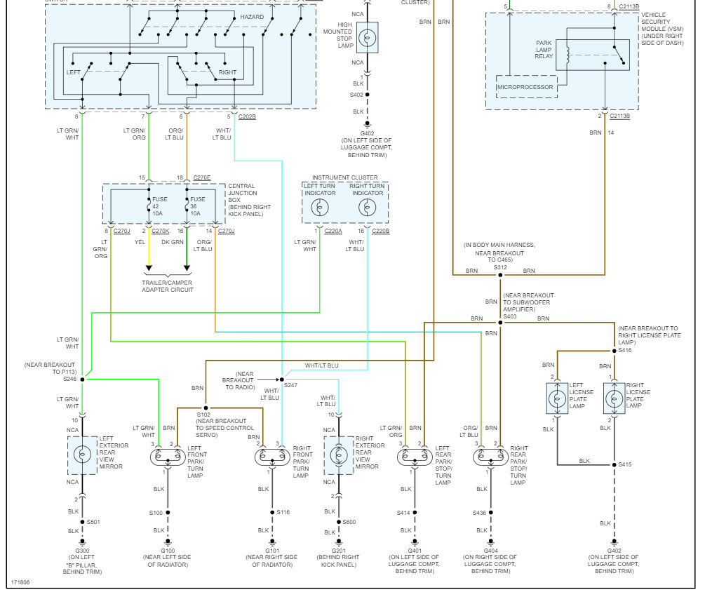

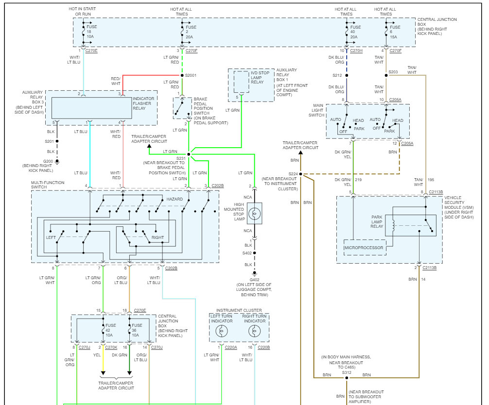

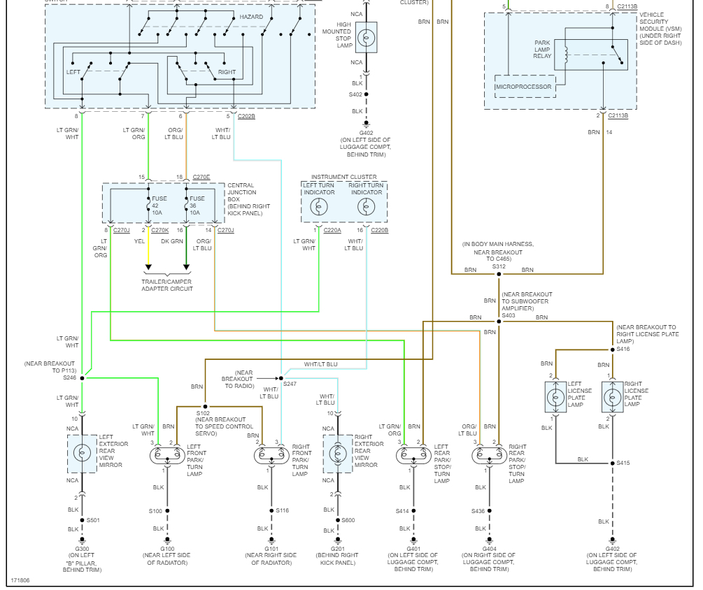

Here is the brake light wiring diagrams so you can see how the system works. Check out the images (Below). Please let us know how it goes
