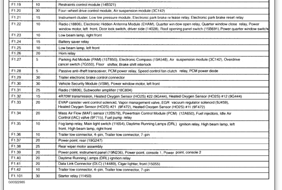

I have a relay in the fuse panel that has blown 2 times in 2 months. If you look at the relay you can see a burned area on the bottom. According to the guide, the relay (#203) controls:
Fuses 32,33,34 (Whole bunch of stuff)
Fuel Pump Relay
PCM Solenoids and Sensors.
Any ideas what it could be or where to start looking.

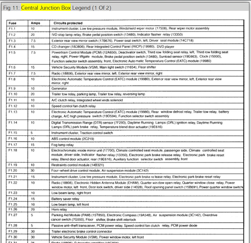

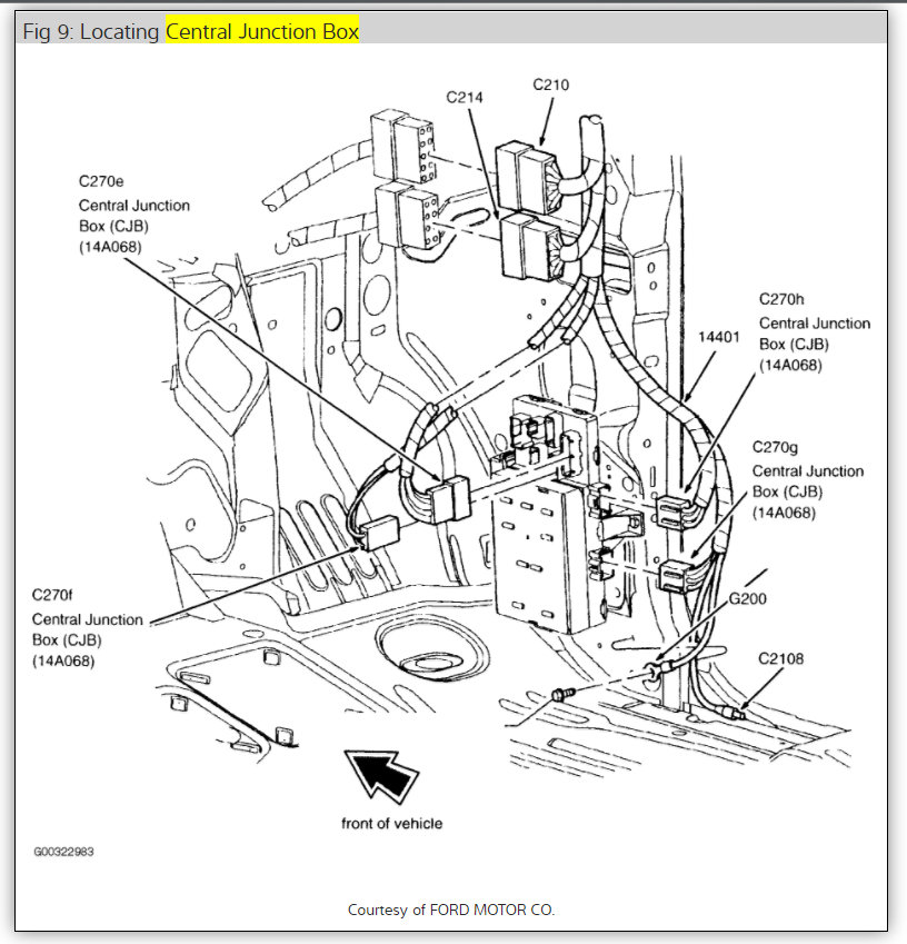

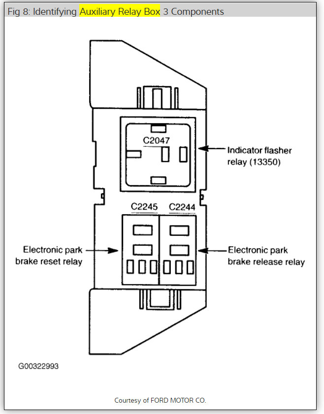

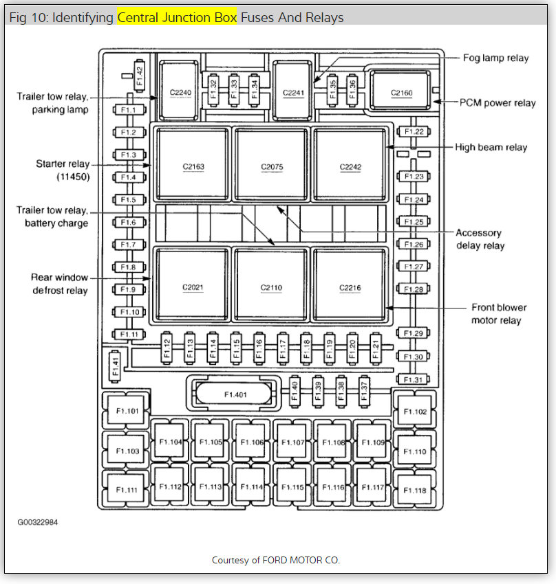

I would start by fixing the burned connection and install a new relay. Then put in a lower amp fuse and turn ignition on and wiggle harnesses and try to duplicate short. Check at O2 sensors for melted harnesses.
Here are the relay and fuse location along with a guide to help you test the relay once you find it.

Thank you this was the problem and my car is running again :)
