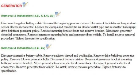

I need detailed information on how to replace an alternator for a 2003 ford expedition. I changed the battery after my truck was running sluggish, kind of like no fuel was getting to the engine but I think it was electrical. AFter changing the battery it was fine for about a day and a half, but is showing signs again of poor accelleration, and previously a check charging system light flashed when I was having problems. I think its the alternator. Please advise. thanks for your help.
