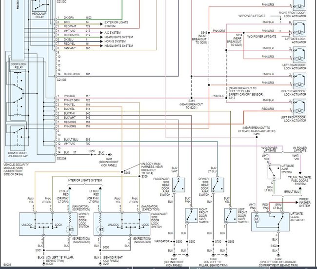

I have a problem with the door locks. 3 of the 4 doors do not lock with the keyless entry or if I lock them by using the lock buttons on the door. Any idea what the cause would be?

The first door to have the problem was the rear passenger side. I also know the driver door is having the problem. I believe the 3rd door is rear driver side. To answer your other question the driver door is stiff when locking manually. Is it the actuator that is bad? It sounds like this is a common problem with Ford's. Any idea if it is the actuator where I can buy them at a discounted price?

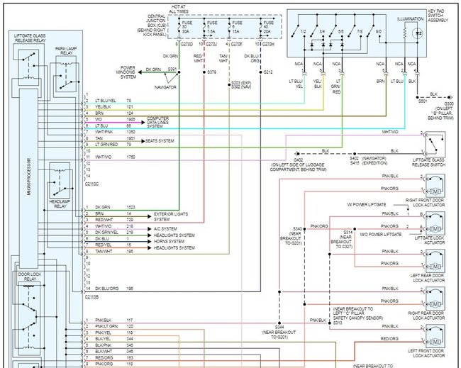

With an issue like this you should check for power/ground at the actuators when operating the switch
See the guide below on using a test light, it will help
Attached below is the wiring diagram for your power locks

the actuator may be bad, check to see if it's getting power and check all your fuses.

check the #3 fuse in the power distribution box it is mounted on the fenderwell on the driver side in the engine compartment

It sounds like what is happening is one of the door latches internal switch is going out so it thinks the one of the doors is still open and toggles back and forth when you drive. Roll the windows down and shut all door and turn the key to the on position. Wait until the dome light goes out then walk around the car and pull on each door until you see the dome light come on that will be the door the latch needs to be replaced in probably the driver's door if I were to guess.
Please run this test and get back to us.
