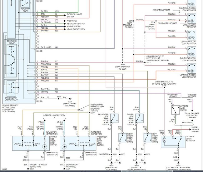

With an issue like this you should check for power/ground at the actuators when operating the switch
See the guide below on using a test light, it will help
Attached below is the wiring diagram for your power locks
Jan 21, 2019 at 7:59 AM

the actuator may be bad, check to see if it's getting power and check all your fuses.

Have you checked for power to the actuator?
