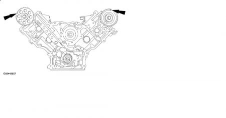

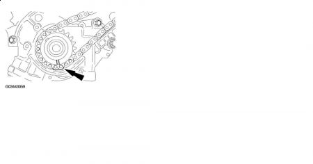

need help,4.6 lit. Romeo eng. timing chain began to chatter about a month ago. was not sure what the problem was until about five days ago. here is the problem,,, coming home the oil light came on very quickly got off the fwy. shut down the motor and checked the oil level it was fine, started back up no problems other than the timing chain chattering. oil light did not come back on. 4 or 5 minutes down the road it did come back on still no noise from motor pulled over because it had no power to climb the small grade. shut it down and called AAA. waiting for the tow truck i tried to start it no luck.
this motor is not free spining how do i get it to TDC?
timing chain is not broken, but the guides have some damage from the chain and the tensioners appear to have been rubbing the chain, all the help i can get is appreciated......

Its not good if it isnt turning over.May have hit some valves, that is whats stopping the crank from turning.There are bright links on the timing chain that are used to align the cams and crank.You may need to play with the cams and crank, turning a little bit at a time to see if you can get all of them to turn enough to align everything.The only other option is to get the on the car service tool for the valve springs and remove all of the followers so the valves arent lifting, then you should be able to turn the engine around without hitting anything
https://images.2carpros.com/forum/automotive_pictures/1639_ford1_1.jpg
https://images.2carpros.com/forum/automotive_pictures/1639_ford2_1.jpg
